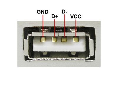

Step 2: Modifying the Usb Port
Okay! first off, go desolder the old usb-b port from the board
Then superglue the 4 terminals of the female usb port, we'll need this because the terminals tend to slide out! these terminals are just held down by the crease on the plastic seen on (see pic 2)
great, now that's done pull out the pins just like on the third picture and lay them down flat
Then solder the wires to the corresponding pins:
  • Red is to vcc
  • Green is to D-
  • White is to D+
  • Blue is to Gnd
When you're good with that, see my reference to the pinouts of usb-b? follow it and solder to the board, you can use the fifth picture as your reference.
lastly, solder the 2 supports of the female port
