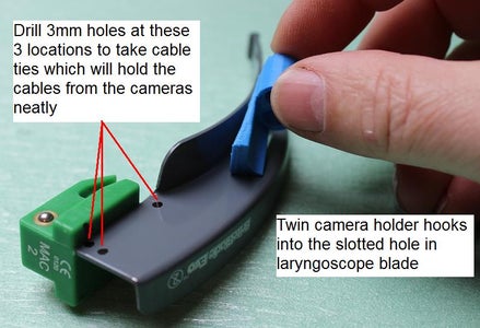

Step 13: Insert the Twin Camera Mounts and Drill Holes
The camera mount has a hook at one end that locates it into one end of the elongated slot in the laryngoscope blade.
Also, at the points marked, we need to drill 3mm holes to take small cable ties. These will be used to tidy up the cables emerging from the rear of each camera.
Step 14: Fix the Double Camera Mount in Place
I used a very short screw with a tab to locate the other end of the 3D printed double camera mount at the other end of the slot within the laryngoscope blade. For other makes of blade you will need to modify this slightly.
You can also see how the cable ties are used to tidy up the wires emerging from the rear of each camera (cameras not visible here as they are on reverse side of the laryngoscope blade).

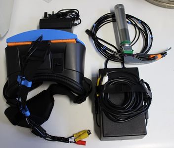

Step 31: Finished Scope and Wiring
Here is the scope and wiring tidied up ready to connect to the headset.
Step 32: Whole Assembly Completed
Here is the whole set of apparatus ready for testing.
