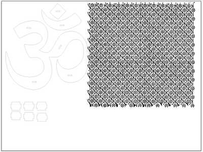

you need to make a vector file for the laser cutter. The way I draw my images is usually live tracing and expanding images on the internet to turn them into vector / raster.
2.

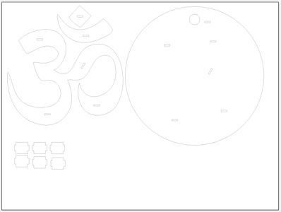

create box holes in your drawing that are 0.1x0.48in. these will be smaller than the actual fixture dimensions because the laser cutter has a thickness itself and exact measurements won't work and will be loose.
3.
copy your image with the box holes over your background cut and delete the image leaving the boxed holes exactly where you'll attach the pieces on later. Also add a hole to the top of the background piece to allow you to hang it.
4.
then you create your fixtures. the main body i 1x1in with 0.25x0.5 tabs sticking out of both sides. the number of fixtures should be the same as the number of boxed holes you made in your image.
5.
add a pattern to your background / image. i personally grabbed patterns online in live traced and expanded them to add the complicated patterns on my pieces. In this one I just added it over the background.

Step 2: LASER IT!
Set your laser cutting settings for 1/8 ply wood and let it go! You should end up with this general setup.
