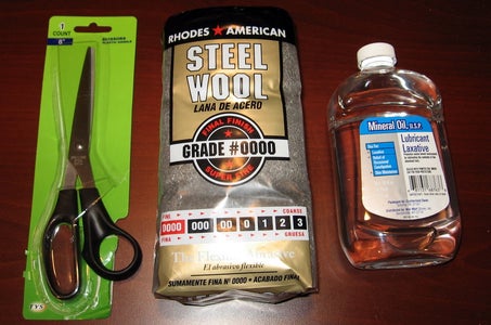

I went to Walmart and got the following items and brought them back to my Hotel.
1. Fine steel wool.
2. Bottle of Mineral Oil in plastic bottle.
3.Scissors.

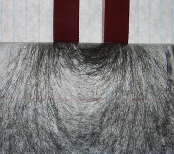

Step 4: Test the Viewer
Place a magnet against the bottle. The viewer will show the lines of force.

    We did this in science class but we used iron powder instead and it didn't work too well. I think the shredded steel wool is much better.
    0
    botronics
    botronics
    Reply 10 years ago on Introduction
    You need long fibers so they can twist and align in the field like little compasses. Iron powder may rotate, but you won't notice it.
