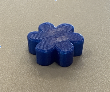

First step, as it goes in the design process, was to sketch out the design of the flower. Due to certain parameters for this assignment, based on the casing size needed, the flower must be within a diameter of 38mm and height 37mm fitting with 4mm clearance from the outer edge of the casing and with the height being 7mm shorter than the top of the casing (max height 30mm). This meant that I was gonna design a pretty small flower and I wanted it to be good size for chocolate bites.
Step 2: Designing on Fusion
To design this flower on Fusion 360, I started with a pre-made file of the casing with the correct dimensions. I then began a sketch on the bottom of the casing and first drew a construction circle using the parameter of 30mm to ensure there was clearance on all sides. I used the 'spline' tool to create a petal curve from the center of the flower to the edge of it and extruded the sketch to 6mm with a 3 degree draft angle to ensure it fit inside the height requirement. After extrusion, I used the circular pattern feature to copy and replicate the petal around the vertical axis to create 6 evenly spaced petals. To then round out the edges of the flower, I used the fillet tool and set it to 1.00mm. This created the perfect mold however, the draft angle should've been negative 3 to further prevent the mess-up when gluing the flower to the casing.
Step 3: Exporting to 3D Printer
Once the file was saved from Fusion, I exported it to the 3DPrinterOS page and submitted it to a printer. The makerspace was able to finish it for me and take off any supports used to provide the final PLA printed form.
Step 4: Silicon Mold
After all forms were printed, we glued each down to the casing bottom with Gorilla Glue Adhesive spray and let it dry to create a strong seal for the mold. It was important to glue the 'flat' side down on the bottom of the casing however the first attempt at gluing it I glued the other side. When I re-glued it, it then became quite messy and the adhesive beaded on the top of the flower, therefore adding interesting texture to the overall mold. We then mixed the food-safe silicon for 3-5 minutes, being careful not to create air bubbles in the mixture, and poured it into our casings. After tapping all the bubbles out of the casing, we let it sit overnight until the silicon hardened.
