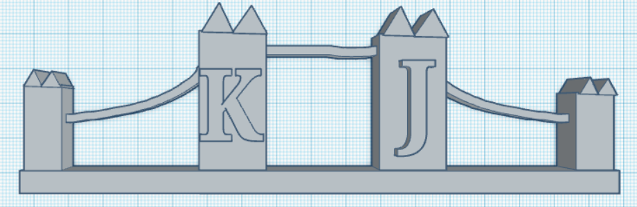

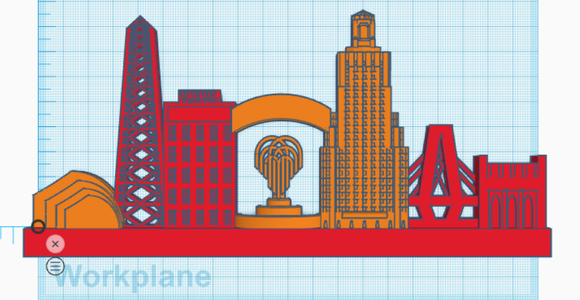

This is everyone's favorite part; let's get tinkering! My class is often students' first exposure to 3D printing and Tinkercad, so the complexity of design can be scaled up or down as needed. The 3D Design Process can be chunked into smaller steps as students design one building at a time. I encourage students to think about what shape the building is and what shapes they can use from Tinkercad to create the design. If students are stuck on where to start, have them drag out several cubes and vary the size to create rectangular buildings of different heights.
I'll also remind students that we can make our own shapes by grouping solid shapes and holes together as needed. Duplicating shapes or even entire buildings can also be useful. Students have also utilized the sketch tool to create the shapes they needed.
Encourage students to make their 2D sketch three-dimensional by varying the height of each building. This will add depth to the design and create a more interesting finished product.

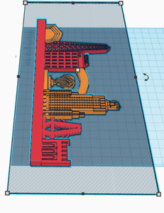

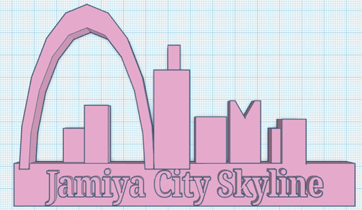

Analyze the design for overhangs. Depending on how students oriented their designs they made need to rotate the design 90 degrees (using the arrow) and drop the design to the build plane (using the hotkey d). The entire design should be printing flat of the work plane. After the design has printed, then students can stand the design up to display it. It is also helpful to create a base that will allow the skyline to stand on its own after printing. This base can be modeled easily with a wedge or cube shape. The base is also a great place for students to title their design or to write their name using the text feature.
If the design is not flat on the work plane, one trick you can use is to create a large rectangle with a short height (i.e. 0.2 - 1mm) and group the large rectangle as a hole across the bottom of your design. This will flatten the bottom of your design evenly and allow you to drop the design to the work plane and print it flat on its back.
