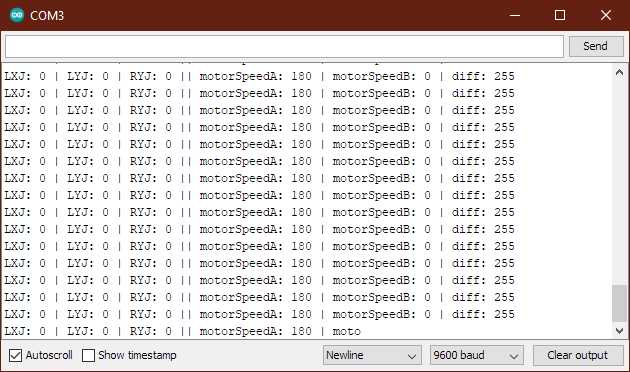

Hi again, I am now in the building process of this project and have run into some issues. When I pull up the serial monitor for the Tracked Car Code it looks like this.When I try to activate the tt motors or the servo motor using the controller nothing happens, but when I take it off the usb and turn the switch on only one motor turns and it just spins without stopping. I re-checked and everything is wired the same as you done in the video. Do you know what could be causing this?
Also my serial monitor for my controller code is pretty close but not exact. The numbers change like they are supposed to when I move the joystick, but the numbers aren't the same as yours. I did leave out the potentiometers if that would affect anything like this.
Reply 10 days ago
Hello,
Sorry for the late response, I think your controller is not communicating with your tracked car, so check the communication.
Hope this helps

Hi, did you figure it out what was causing your issue? I have the same problem, but it seems it doesn't see the controller either.
Reply 3 months ago
Hi I am having the exact same problem. Did you ever figure out how to fix it?
Reply 3 months ago
Hi, one of my NRF24L01 transceivers didn't work. There was a soldering issue on the board that I had to fix. And the thing is, if you turn the rover on before the remote controller, one of the motors will spin at full speed. Obviously the same thing happens if one of the transceivers doesn't work. So the power-up sequence is: remote controller -> rover. This is a bug somewhere in the code, but never bothered me that much that I'd fix it.
Reply 3 months ago
Ok I'll try to do some troubleshooting and see if they are the problem. How exactly did you find out that your NRF24L01 wasn't working?

I hooked up the NRF24L01 transceivers with the Arduino boards and uploaded a test code. I can't remember which one I used exactly, but it was something similar to this:
nRF24L01 – How It Works, Arduino Interface, Circuits, Codes (howtomechatronics.com)
Reply 3 months ago
