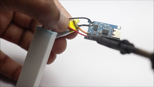

The circuit is much of soldering only, We will connect the battery directly to the charging board followed by soldering the wires.
Output pins from the board will be connected to the LED and in between we are adding the switch, The switch is a general on and off and the smaller the switch the better.

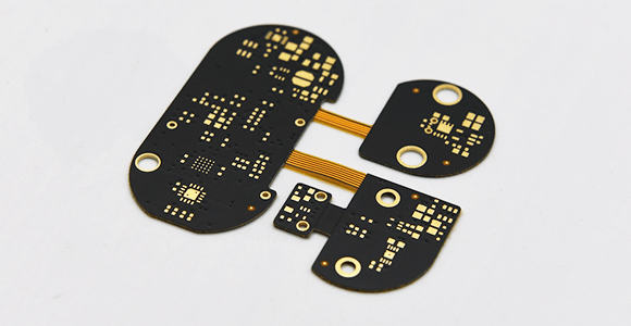

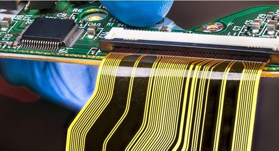

Check Here for Rigid-flex Pcbs with this your circuit becomes flexible! I have added the images to this step kindly check.
They are now providing colorful PCBs printing services too check it here
A revolutionary solution that combines the best of both rigid and flexible circuitry to elevate your electronic projects to new heights.
With their expertise in advanced manufacturing techniques, they offer a seamless integration of rigid and flexible components, ensuring enhanced reliability, durability, and space-saving benefits

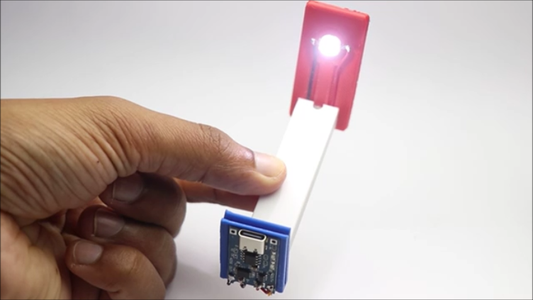

Step 4: Building Circuit
After you have seen the circuit diagram we can begin with the soldering part, Remove the insulation of wire and solder the copper to the LED pins,
Make sure to solder this properly and not leave any overhanging solder, Repeat the same step for other side of the led pin too.
This LED already has heat dissipation plate at the bottom, This part should not touch the 3d printed frame directly so what you can do is add a drop of superglue on either sides and place the legs of LED on this glue.
This method creates a layer of airgap between the frame and plate of LED that helps in getting rid of heat from LED.
If there are suspending wire glue everything to the frame so there are no overhangs that might cause problems later,
Add the switch to the end of wires and then we can head over to the next steps.

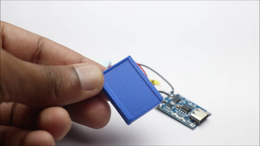

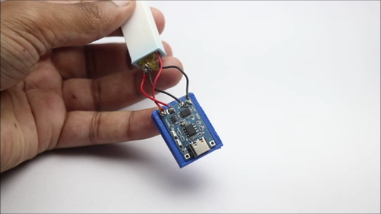

Step 5: Battery Setup
This was a little complex for me and i will tell you why I'm saying this so that you can avoid this.
Initially i soldered thick wires to the battery and the charging board, this made the flexibly of wire go in vain and in return i faced issues when i added this part to the light stand.
Later i replaced those thick wires with thin and little longer ones, and this fixed all issues, After this we can solder the wires from the switch to the output pin of the charging board.
Now in the end use a drop of superglue on the backside of the clip and stick the charging board, Finally couple the led stand to the clip using superglue.

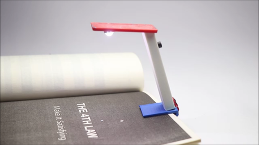

Step 6: Finishing and Testing
At this step our reading lamp is almost ready only one thing that is pending now is selecting which of your favourite book to read.

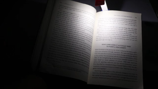

I took some of my time and selected all time favourite book, Test the light once by switching on the button.

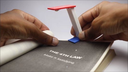

If the LED is not bright, Put the battery for a.Full charge and wait for sometime, Now all you have to do is clip this light below set of pages that you will be reading.
You can also use this clip to mark set of pages that you will be reading today(only for beginner readers this is because the clip can hold 7 to 8 pages at once)
Adjust the place where you will be keeping this light, i chose on the top part of the book, you can place as per your needs.
