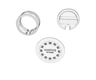

Model consists of 3 parts.
Top plate, middle cylinder, and bottom part that also is used to place electronics.
Qi Charger Print
