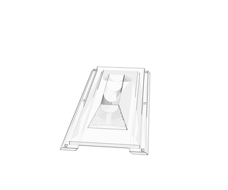

The first thing you'll need to do is print off the Case Frame and clean up the (hopefully) small amounts of support structure. Almost everything snaps or screws onto this, so like most parts in this build it's probably best to print it with a high infill percentage, if not completely solid.

Step 12: Further Reading on the Design
I've added this step just to explain some of my design decisions on the case, and specifically the Case Frame, as it may look peculiar when observed without considering the constraints imposed on it.
My goal at the start of the design was to see if it was even possible to design a reasonably simple, small mITX computer case that could easily be printed on a desktop printer and assembled with minimal additional hardware. The parts of a PC that really dictate the size of the case are the motherboard and video card unit. Even on their own these dictate a pretty big build volume, especially when considering a full size gaming video card. When a power supply big enough for that video card is also considered, the dimensions of the case push the limits of what desktop printers have to offer. Luckily the Rostock MAX v2 has a tall cylindrical print volume capable of fitting a motherboard-videocard unit on its end with a power supply stacked on top and even leaves some room to spare for designing a case frame around it.
I wanted to minimize any scaffolding/support structure that was printed to make assembly easier and keep waste material down, so that meant keeping any overhanging structure short and most holes small. I wanted to minimize additional hardware, so I decided to try 3D printed clips/snaps to attach parts to the Case Frame. There also needs to be room to install some fairly large parts and the case needs airflow to keep those parts cool, so that means big openings.
The result I came up with is that the back face of the Case Frame, with its large motherboard and video card IO holes (sized to spec, and scaffolding free), is printed flat and a large stiff solid face is printed vertically from it that the motherboard and power supply will mount to. Also printed vertically from the back face are two long thin spars that reach all the way to the front of the case. These serve as snap locations for the exterior panels of the case while leaving large openings for component installation and airflow. They aren't connected at the front of the case (as that would require piles of scaffolding) or supported in any other way. While they may initially be somewhat fragile, each exterior panel that gets snapped on will increasingly brace each spar.
Another benefit of all the exterior panels being snap-on, is that each is completely customizable, provided they still have locations for each snap. Should someone want locations for an extra fan, to do away with my silly handle, extra venting in the top, or a total redesign of the exterior geometry, it's all possible as long as the surface that mates with the Case Frame remains unchanged.
Speaking of the handle... I didn't want to trust the six small friction fit snaps to carry the weight of the entire case, so I designed the right, left and front panels of the case to overlap the edges of the top panel. When lifted by the handle this should allow the weight of the case to be borne not just by the 6 parallel snaps in the top panel, but also by the 16 perpendiular snaps in the side panels.
