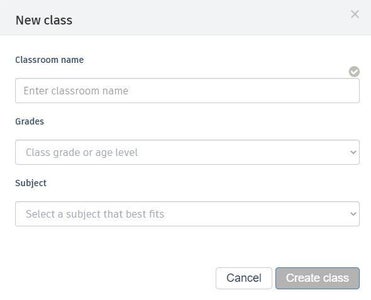

Teacher: Create an educator account on www.tinkercad.com

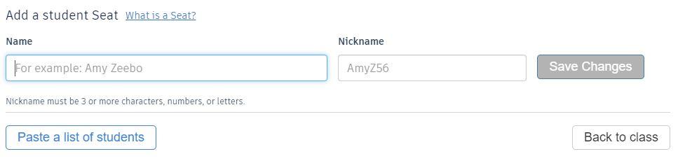

Set up classes and add students (See images above)
Click on the CLASS CODE icon
  • Follow the directions on the next screen that will pop open to have your students join the class
Once students are in the class, they can complete the tutorial videos that will automatically show up on their screen.
Teachers will now have the ability to see their students designs AND also go in to their designs on their end to help/fix designs

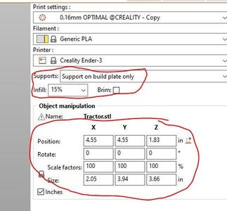

Once students send the teacher/moderator their STL file, the teacher/moderator will have to slice the file into a gcode and send that gcode to the printer for creation unless the students have the ability to download a slicing program onto their computers. (My students did not have that ability, so I sliced them all.)
I use Prusaslicer for all my file slicing. This is a free, downloadable program.

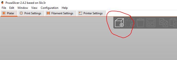

Once I download the STL file from the students, I import it into Prusaslicer, add support material if needed, resize as needed, and create the gcode.
Next, I export the gcode to my SD card and take it to the 3D printer for printing. (I have Ender 3 3D Printers).
The images above show the step by step process in Prusaslicer.
  • Importing an STL file
  • Imported image and additional tools

  • Slice setting options
  • Optional support addition
  • Scale
  • I made artifacts generally around 1.5x1.5 to fit in the shoe box and also cut down on printing time.
  • Slice
  • Export
