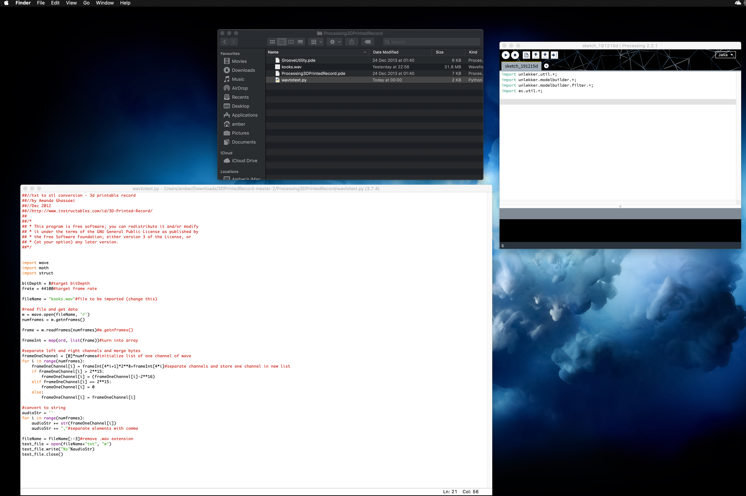

In this Instructable, I'll demonstrate how I developed a workflow that can convert any audio file, of virtually any format, into a 3D model of a record, and how I optimized these records for playback on a real turntable. The 3D modeling in this project was far too complex for traditional drafting-style CAD techniques, so I wrote an program to do this conversion automatically. It works by importing raw audio data, performing some calculations to generate the geometry of a record, and eventually exporting this geometry straight to a 3D printable file format. Most of the heavy lifting is done by Processing, an open source programming environment that's often used for 2D and 3D graphics and modeling applications. Here's a basic overview of my Processing algorithm:
use raw audio data to set the groove depth- parse through the raw audio data, this is the set of numbers that defines the shape of the audio waveform, and use this information to set the height of the bottom of a spiral groove. This way, when a turntable stylus moves along the groove it will move vertically in the same path as the original waveform and recreate the original audio signal.
draw record and groove geometry- A 3D model is essentially a list of triangles arranged in 3D space to create a continuous mesh, use the data from the last step and some general record parameters (record diameter, thickness, groove width, etc) to generate the list of triangular faces that describes the record's shape and the detailed spiral groove inscribed on its surface.
export model in STL format- the STL file format is understood by all 3D printers, export the geometry calculated in the last step as an STL file. To get Processing to export straight to STL, I used the ModelBuilder Library written by Marius Watz (if you are into Arduino/Processing and 3D printing I highly recommend checking this out, it works great).

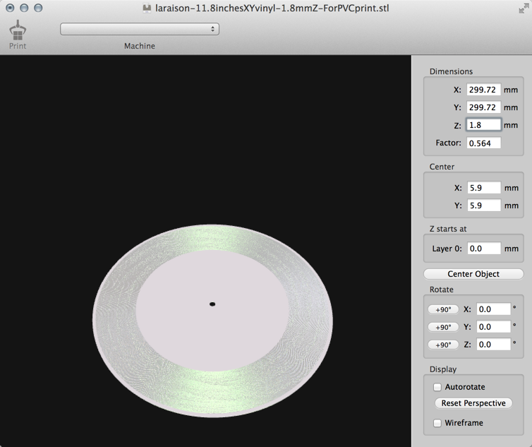

First I prepared some test files to print to get an idea of what is possible with the printer and optimize the dimensions of the grooves. These record files have circular grooves on them containing sine waves of various frequencies, amplitudes, groove depths, groove widths, and beveled groove edges. (When I say that the groove "contained" a sine wave, I mean the bottom of the groves moves up and down in a sinusoidal pattern around the record). I generated all of these files in Processing using the ModelBuilder library to export straight to STL.
TEST ONE:
My first test record had 72 grooves on it, screen shots of the model are shown in figs 2 through 6 I tested two frequencies of sine waves:
1000 cycles per revolution = 555Hz at 33RPM
500 cycles per revolution = 277Hz at 33RPM
I tested a few different amplitudes, depths, and groove widths for these frequencies and gave each groove a constant bevel size of 2px on each side (you can see in fig 5 how the edges of the groove flare outward). I printed the record in Objet's Vero Clear material, this material is a fairly hard, clear resin. I printed the file with the "smooth" setting to prevent any support material from being deposited in the grooves. Unfortunately, when I was ready to make this print we were having some problems with power in our shop, so I had to use another Objet machine that was not set up for high resolution printing; the best I could do was 300DPI X/Y resolution with 30um Z steps. This is half the resolution that each of these axes is capable of, meaning the print came out at (1/2)3, or 1/8th resolution overall. The results are shown in the video below (the grooves were not deep enough to keep the needle inside, so I had to hold in it place with my hand). The record was also a little big for my record player, I decreased the diameter of my STL file to 11.8" in later versions.

At the end of all these tests I learned a few things about 3d printing records with the Objet:
Groove Depth min of 48um below top of record - I found that grooves that kept the waveform at a minimum of 48um (or 3 16 micron steps) below the top of the record kept the needle in place while being played. This was true for all the frequencies I tested.
Groove Width 2px - At lower frequencies I found that the 2px grooves were much less noisy than the 1px, but I didn't hear too much of a difference between 2 and 3px. However, when I tested again with the higher frequencies (2000 cycles/rev) I could hear much more noise on the 3px groove than the 2px.
Frequency Range - at 22000 points per revolution, I easily achieved the upper limit of the human vocal range (about 1.1kHz). Theoretically I should be able to reproduce frequencies equal to half my sampling rate. With a sampling rate of 12kHz (calculated in the last step), the highest frequency I can theoretically achieve is 6kHz. I suspect that the movement of the liquid resin during the curing process will prevent me from actually achieving these frequencies, but if I can just get into the 2kHz range it will still sound reasonably good. Based on the tests I've run so far, I think this is possible.
Dimensions - Although it seems like a 12" record should measure 12" in diameter, I found that printing at 12" made the record slightly too large for my record player. I decreased the diameter down to 11.8" and it worked great.
Max file size of ~300MB - Although Processing is capable of producing much larger files, the Objet Software that runs the printers seems to only handle about 300MB of data at a time. It's possible that increased RAM might bring this up to 500mb, but this still does not give me a lot of room to work with. Although this is plenty for normal CAD purposes, I found out that I would have to be very efficient with the way I packed data onto the STL for the final version of my Processing sketch. One problem with my current sketch is that is has a constant angular sampling rate, this means that the same amount of data is used to describe a groove on the outer edge of the record and a groove near the center of the record. Since the groove at the center of the record is much smaller it would a higher resolution than the outer groove, unfortunately, this extra precision goes to waste because the printer has constant DPI across the entire surface of the record. Eventually, I hope to decrease the angular sampling rate of the inner grooves to save storage space and pack as much audio into the STL file as possible.
Step 4: Extracting Audio Data With Python
Processing has a library for dealing with audio called Minim, it is included with the more recent versions of Processing IDE. Unfortunately, this library is set up for real time audio applications and does not appear give you an easy way of extracting all the data from an audio file at once (it makes you load it in small buffers piece by piece). Since I could not find an easy way to load my wav files into Processing directly (although I'm sure this must be possible), I've been importing stereo audio in the wav format into Python using the wav library, adding the left and right channels together, centering the data around zero, and exporting the resulting array of int's (separated by commas) to a txt file. Here is my wav to txt Python script (I'm running this in Python 2.5.4):
<pre>#Wav to Txt

Once I create a text file, I can import the data into Processing and convert it into an STL. I would like to streamline my code so that audio files (wav/mp3) can be loaded directly into Processing, but I have not found a solution yet, any suggestions would be appreciated!

Step 7: Make Your Own Records
You can convert your own audio files into 3D STL models in ten easy steps:
1.  Download Processing.
2.  Download the ModelBuilder library for Processing.  I used version 0007a03.
3. Unzip the Modelbuilder library .zip and copy the folder inside called "modelbuilder".  Unzip the processing .zip and go to Processing>modes>java>libraries and paste the "modelbuilder" folder in the "libraries" folder.
4.  Download Python 2.5.4.
5.  Download Audacity.
6.  Download the code from GitHub (you can download the files as a zip by clicking on the cloud button).  Open the folder called Processing3DPrintedRecord.
7.  Open an audio file of your choice with Audacity.  Use Effect>Amplify to amplify the signal as much as you can without noticeable effects of clipping (you will be able to get away with some clipping, and remember this is not crystal clear audio anyway).  Make sure there is 2 sec of blank audio at the end of the track so that nothing gets clipped.  Keep the audio under 6 min.  File>Export this file and save it in the "Processing3DPrintedRecord" folder as a wav file.
8.  Open the Python file called "wavtotxt".  Copy the file name of the file you just saved in the line:
             fileName = "your_file_name_here.wav"
Hit Run>RunModule, after a minute or two you will have a .txt file saved in the Processing3DPrintedRecord folder.
9.  Open the Processing Sketch.  In File>Preferences check the box that says "increase the maximum available memory to" and write in the amount of available ram on your computer.  I've found that my laptop with 4GB RAM can handle audio files up to 1.5 min long.  For longer files you will need to use a computer with 12-16GB of RAM.  If Processing starts and then gets stuck or crashes, it is a RAM issue and you will need to move to a machine with more RAM.
10.  Change the name of the import file in the Processing sketch to your txt file name:
             String filename = "your_file_name_here.txt";
Close all other programs running on your computer and run the Processing sketch Sketch>Run.  After a few seconds you will see "record drawn, starting grooves" appear at the bottom of the Processing window.  After some more time you will get updates on the status of the sketch: "3 of 85 grooves drawn".  Eventually Processing will tell you that it is writing your STL file and when it is done it will say "Closing 'name_of_your_file.stl' and tell you haw many faces are in the file.  You can find the finished file in the Processing3DPrintedRecord folder.

    I received an email today from someone asking me about how far I managed to go with replicating Amanda's process, so I thought I'd share my experience in more details.
    Note that this experience below occurred in December 2014.
    My goal was to try print a 3mn song on 1 side of a 12 inches vinyl and see what is the best quality and output I could achieve, noticing that it has been already more than 2 years since Amanda did her project, so I assumed that the technology would have progressed rapidly.
    Amanda's instructions and provided programs help you generate the binary file, then create a 3D model (STL file) for a one sided vinyl with that song on it (eq'd specifically for vinyl previously as per the video). At this stage, I don't know if you can even generate a two sided vinyl STL model but this didn't matter to me for that experience.
    I downsampled the file to 12hz as per her initial instructions and default settings. The outcome was a file that was 700MB. Generating this file alone requires HUGE amount of processing power. Note that I'm using a Mac Book Pro with 16GB of ram, solid state drive and a very powerful processor. It was nevertheless a painful process for the computer to generate the file. See attached an image of the model. You'll note that the entire surface is not covered, which I couldn't quite figure out why. I assumed that if it did take the entire width, the grooves would be a be bigger and therefore more tolerant to the level of precision currently available via 3D printing.
    I then tried changing the downsampling rate to something higher (I started at 24hz), so I could get to a quality closer to what I'm after (i.e. that can be released). It looked something like this:
    Unfortunately, the file couldn't even get generated. My computer would hang permanently. That wasn't even trying 44hz which is what I was ideally after...
    To note: the output STL file had dimensions for X and Y initially rendering in mm instead of inches for some reason so something to keep an eye out on if you try that technique using Amanda's program (unless it had to do with the program I used to render the shape - I then had to update the dimensions manually to the equivalent in mm).
    I stuck to my 12hz downsampling rate then and contacted the most advanced 3D printing company in Melbourne I could find (3Dsystems.com). They had by very far the best machines I could find on the market for once off printing. I figured this would provide me already with a significant improvement of quality from what Amanda had produced.
    The machine used was SLA Flex Printer with XHD 0.050 mm layers. Resolutions were uniform on all 3 axis, XYZ with all parts having an accuracy of 0.001 – 0.002 inch per inch of part dimension. This was by far the best printer I could find. The material used was 'Accura Xtreme'.
    Unfortunately, the machine and vinyl would break before it could be fully printed, the file being far too large. Files are generraly a few dozens MB at most, and Amanda herself mentions that 300MB is already pushing it.
    Doing some further research, I then thought that the model may be using a lot of polygons which are not required to print all the details. I therefore asked Amanda if she thought we could use a technique called decimation to remove useless polygons and therefore make the file lighter, but she confirmed that the program she created was pretty efficient. Considering how precise vinyls are in terms of geometry, this makes perfect sense.
    Note that the price quoted to me was about US$250 for 1 copy (price goes down obviously as you order more). Copy of the quote attached.
    As of today, there therefore doesn't seem to be a way to print even one single song in a decent quality. The song I used was just below 3mn and in mp3 format.
    I'm not sure whether there are elements I could have tweaked to change the output (type of printer or material used, settings in the file), but it seemed that as of early 2015, we were still a long way to being able to 3D print vinyls from the comfort of our home, or as an alternative manufacturing process to the vinyl plants (which was the main goal of my investigation here).
    If anyone has tried similar experiences and maybe had better outcomes, I'd love to hear about it.
    Cheers, Charly

    I am facing the very same issue of the file size. The stl file that has generated as a result is with a size of ~250MB. Noting that my printer cannot print a file this large, how can I scale the size down? Did you find a solution to this?

    Yeah there's not a lot you can do to get the file size down - the detail in the grooves that the code currently spits out was the bare minimum I found that I could get away with without impacting quality. I think the best bet is to process a shorter audio file, which will generate a shorter groove with less geometry.

    Hi Amanda! This is absolutely amazing. Real life genius stuff right there. I LOVE your song choices, especially 'Everything in it's Right Place.' I sincerely wish I could see the results of that one... but the youtube video isn't available to me!! Devastated! Anyway:
    I've been trying to follow along with the ten steps as best I can, but I've found some of the steps hard to correlate with the options I get - for example, I did not find a 'zip' file. Instead I had to 'reveal package contents' and then (with some guesswork) pasted the library file into the modules > Library folder. It didn't work, so I re-installed and I also tried this with the 3 previous versions of .Processing'. The 2011 version required me to mess with my Java, so I tried the 2014/15 version instead. Now when I open Processing and hover over 'sketchbook > modes > model builder' it comes up with 6 lines of code - finally! I assume this is the sketch I needed to open.
    However, when I then do the simple process of converting to wav and placing my music file into the correct folder, then running the .py script.... it says 'Traceback (most recent call last):
    File "/Users/amber/Downloads/3DPrintedRecord-master-2/Processing3DPrintedRecord/wavtotxt2.py", line 33, in <module>
    frameOneChannel[i] = frameInt[4*i+1]*2**8+frameInt[4*i]#separate channels and store one channel in new list
    TypeError: 'map' object is not subscriptable'
    So I've no idea what I'm doing wrong. I feel that the failure is either a simple error of mine, or due to the mess of different versions of programmes I'm having to use.
    ANY advice is very much appreciated! I hope this message finds you well. Thanks, Amber :)
    File "C:\Users\balaf06\3D Objects\F79CASMHEBNH531\wavtotext.py", line 34, in <module>
    MemoryError
    Any idea?????
    0
    ipolleri
    ipolleri
    Reply 1 year ago
    Were you able to get a solution for this? I am encountering the exact same error...
