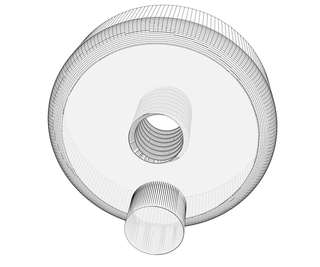

Place the spring over "Bolt Cylinder.stl" as shown, then use it to attach "Cylinder.stl" to "Base.stl" as shown.
Slide "Piston.stl" into "Cylinder.stl" as shown.
Place "Flywheel.stl" into "Base.stl" as shown.
Place the pin on "Crank.stl" into the hole in "Piston.stl", then place the crank into position over the threads in the flywheel, then thread them together such that they are tight, but rotate easily.
