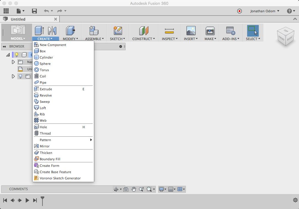

Create: This menu allows us to create new geometry. We can create primitives (spheres, boxes, tubes, etc.) or we can create new geometry from sketches using extrude, sweep, etc.

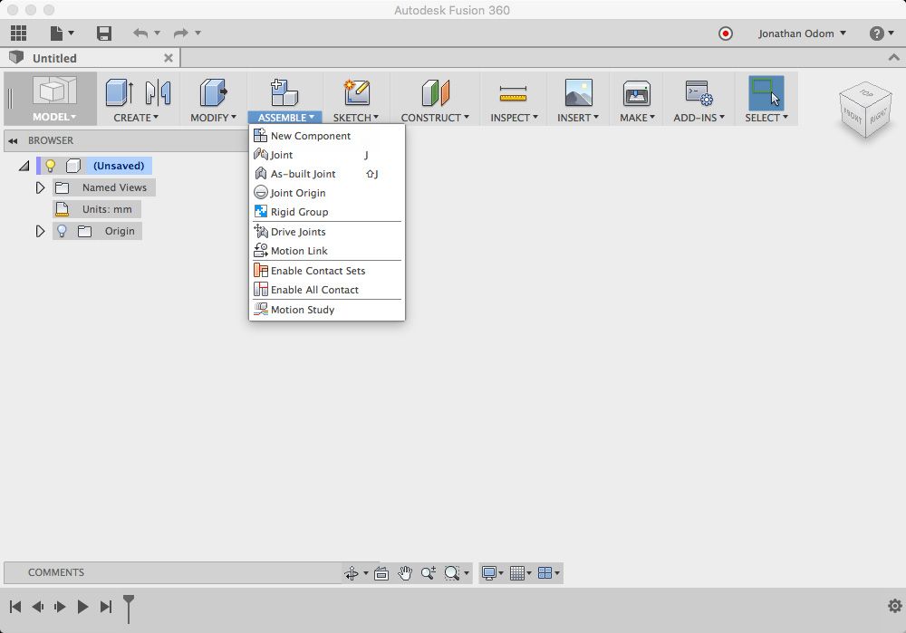

Assemble: This is where we find all the tools we need to create assemblies. Assemblies let us create connections between parts that can move using constraints like Rotate and Slider. We can make hinges, bolted connections, and many other mechanical assemblies that let us design complex objects. We won't be creating complex assemblies in this class, but we'll go over the basics of what assemblies can do.

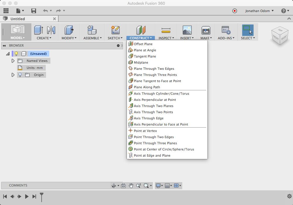

Construct: This menu lets us create planes, axes, and points to aid us in creating and editing geometry.

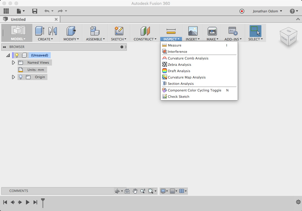

Inspect: This menu has a lot of useful tools that help us understand the 2D and 3D geometry we create. We'll mostly be using the Measure tool to check our work, but this menu also has some very sophisticated analysis tools that will be useful to engineers and professional fabricators.

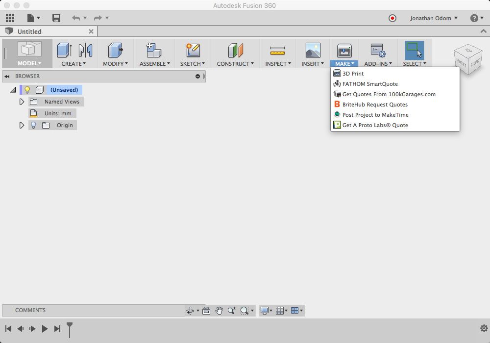

Make: This menu lets us export parts for 3D printing. It also has buttons that connect directly to service bureaus so you can instantly get price quotes on your models.

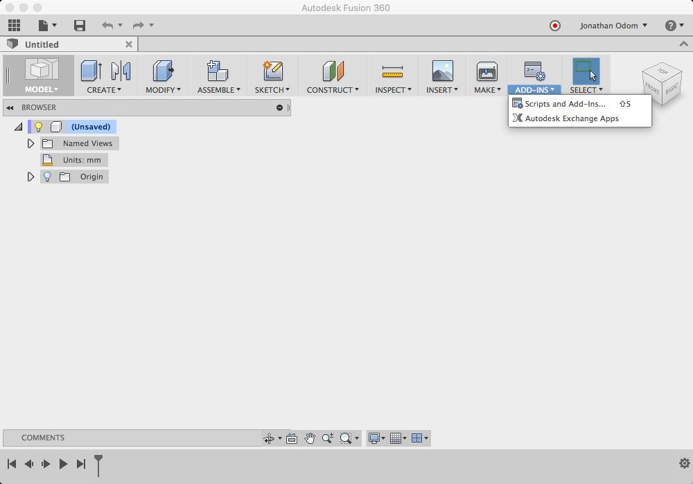

Add-Ins: This menu allows you to add and access plug-in scripts. "Spur Gear" is one of the scripts included with the software that I use often.

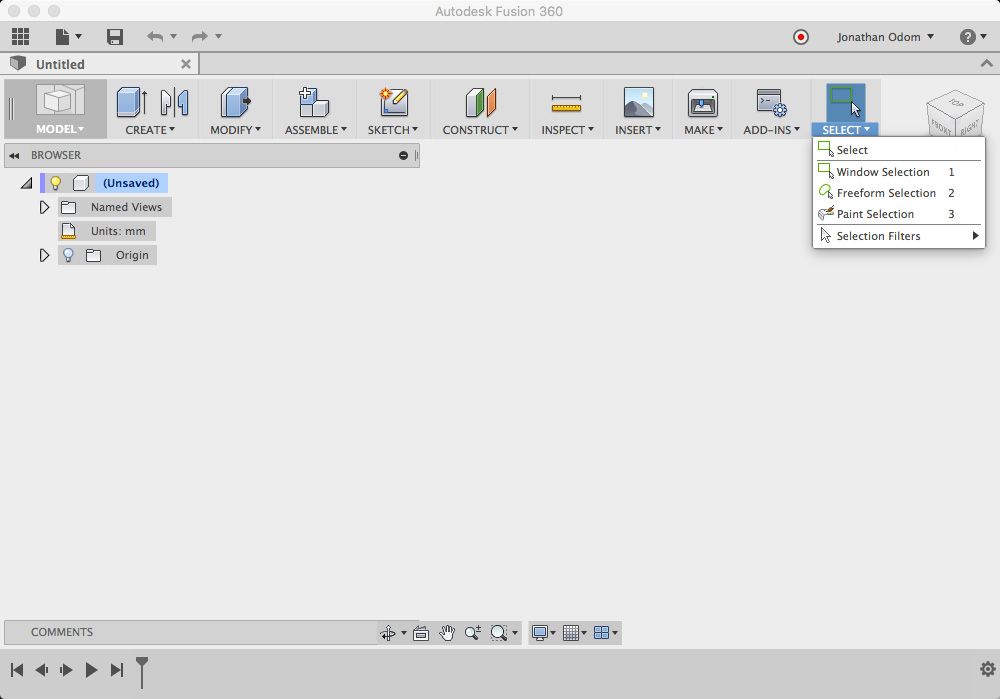

Select: This menu allows you to choose the selection style for geometry. The default is Window, but you can also do lasso selections or freeform (paint) selections. This menu also has the Selection Filters list, which is very useful when your model starts to get complex.

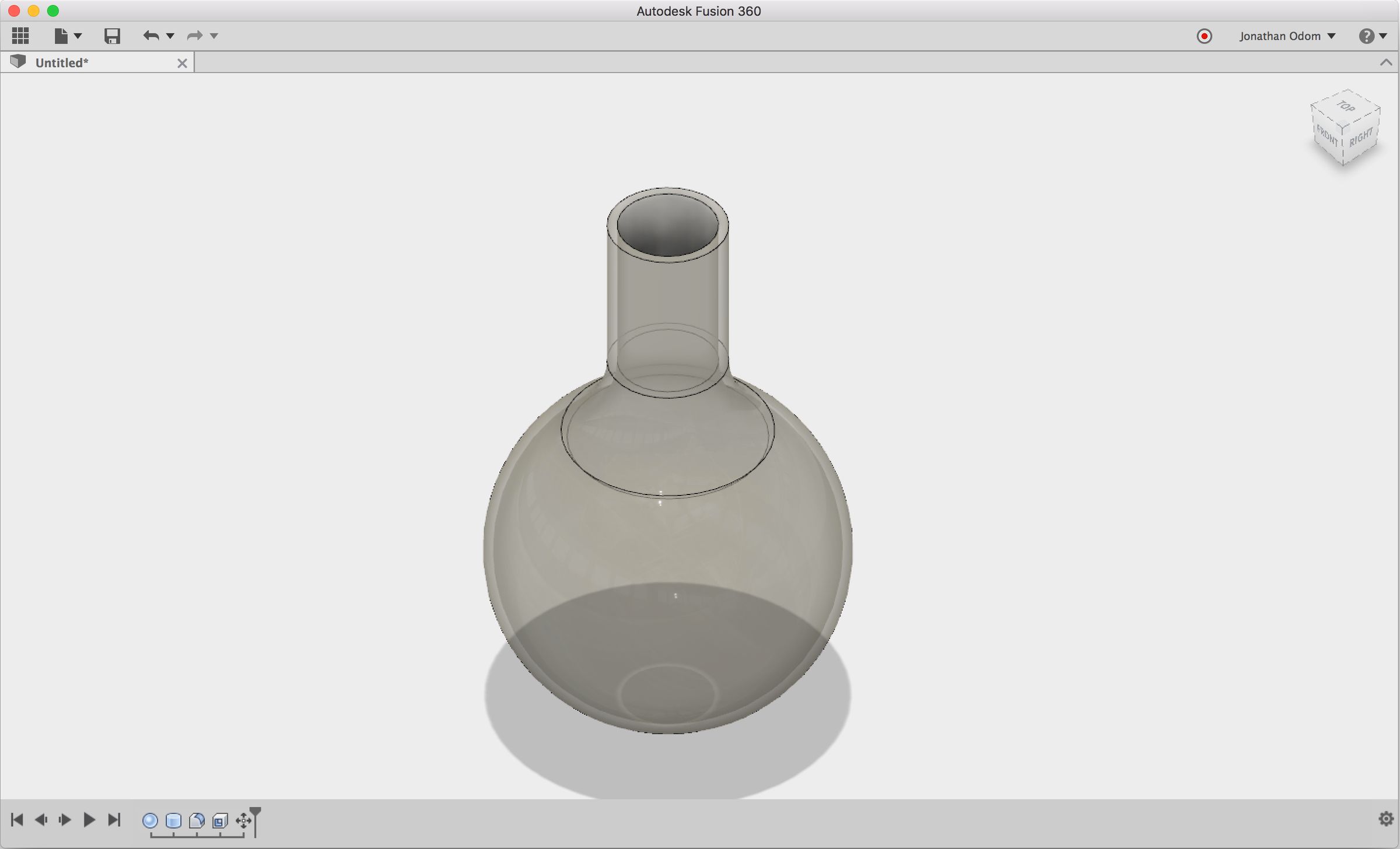

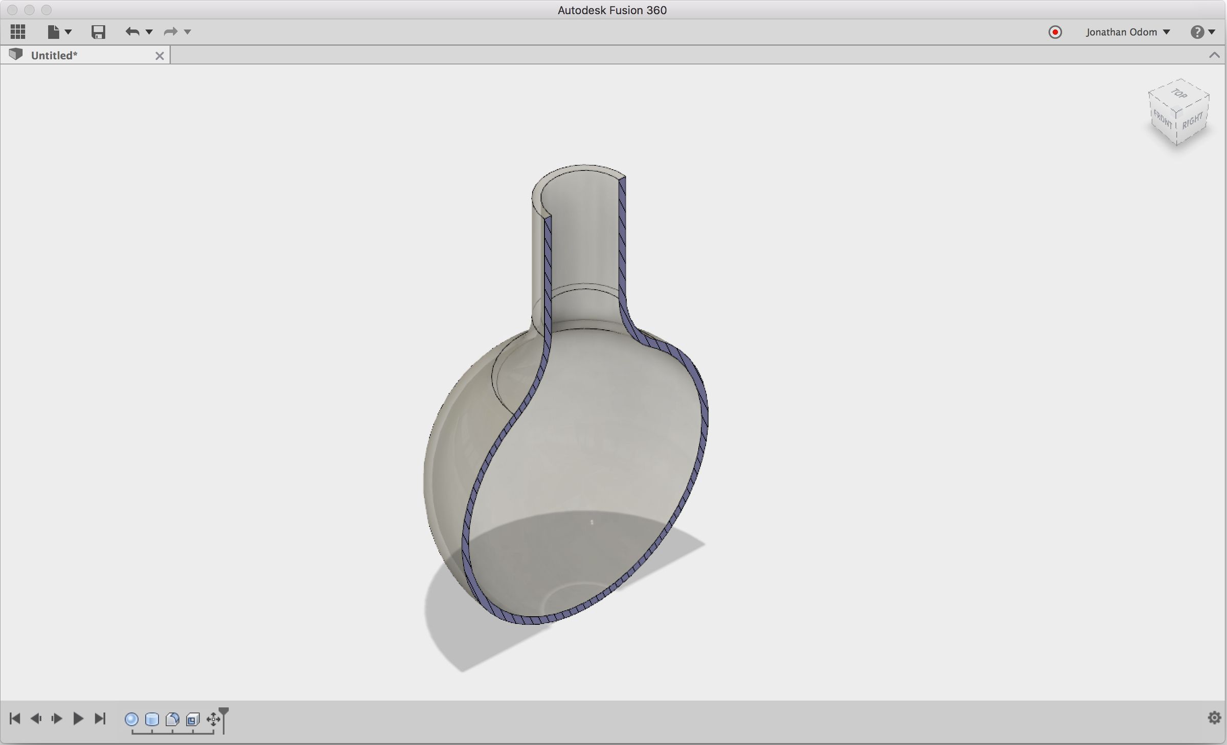

The model in the screenshots above is a glass flask. You could make it using Primitives and the Shell tool, or sketching the profile and revolving it. I used Inspect > Section Analysis to get the section view.

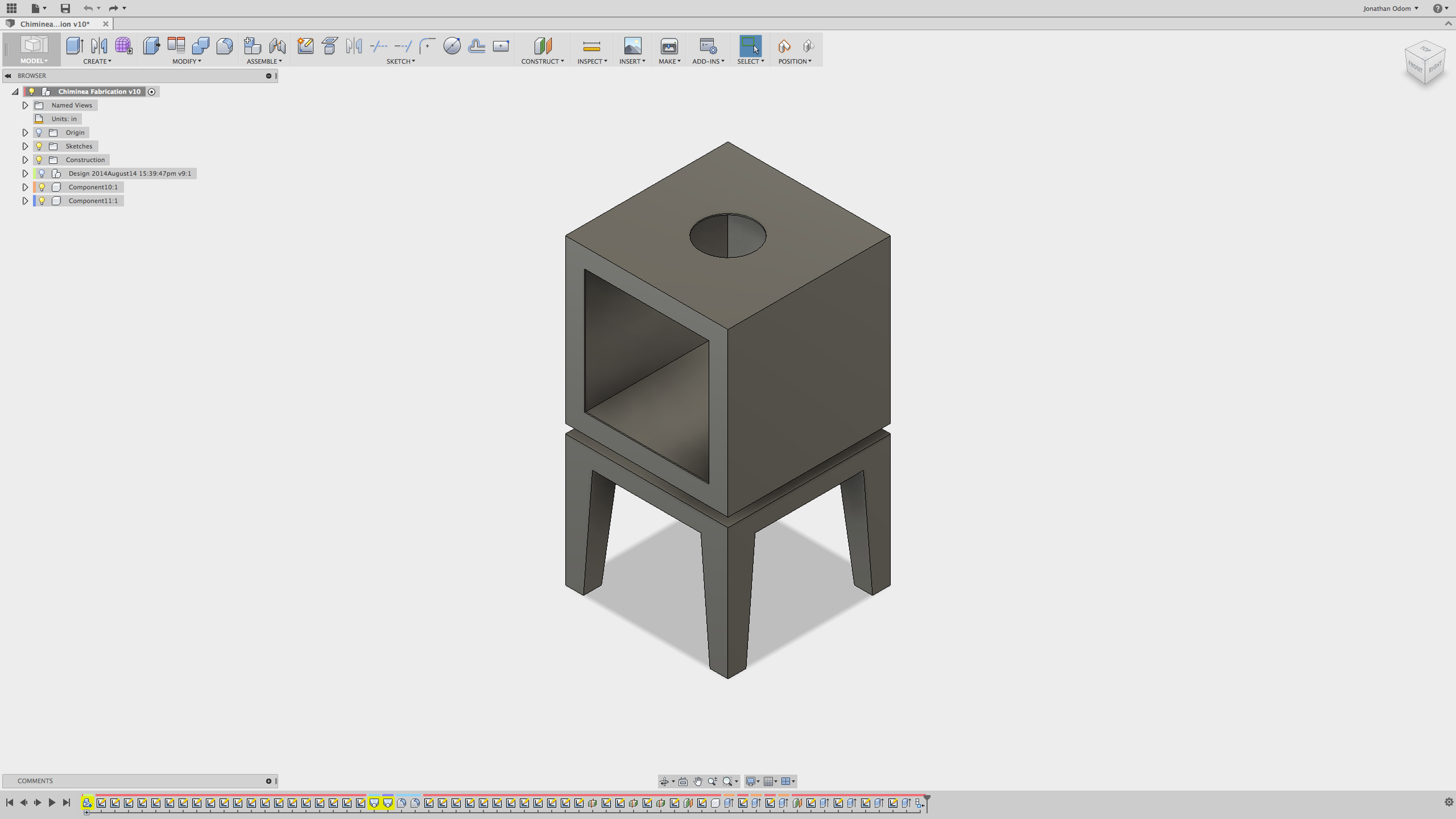

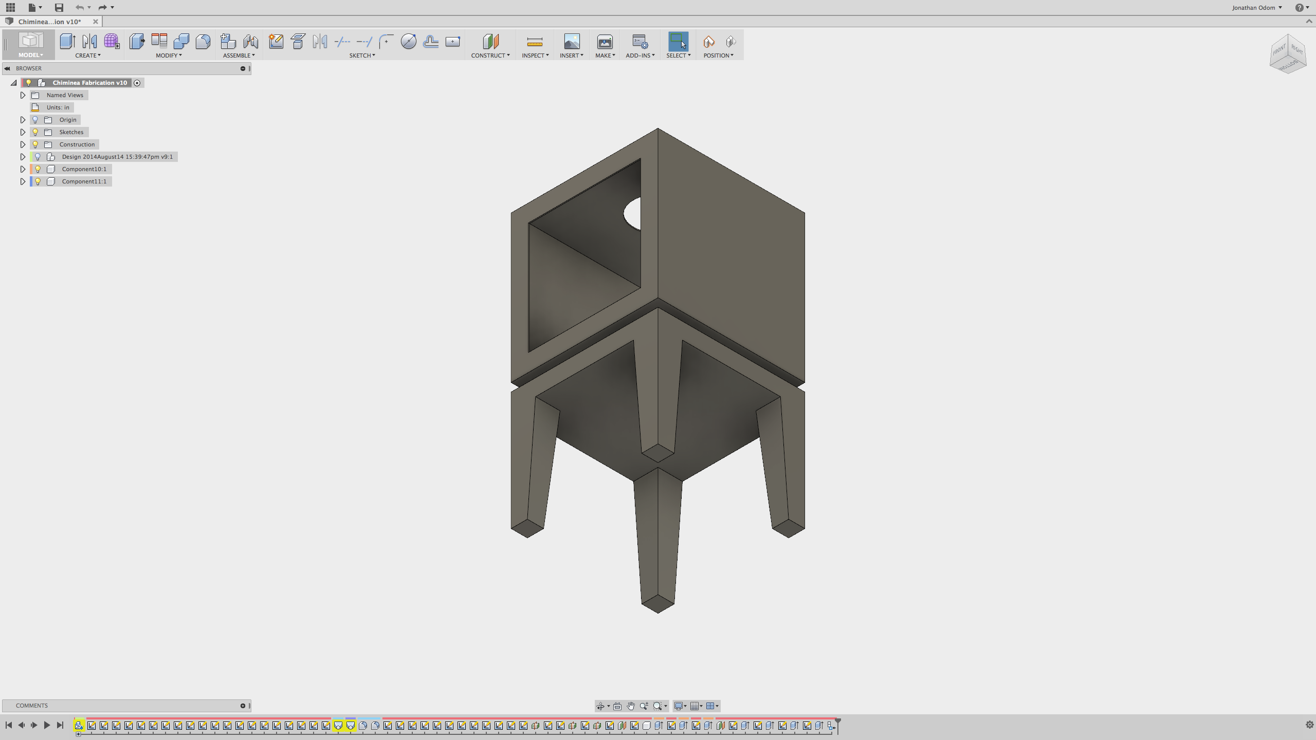

The model above is an idea for an outdoor fireplace made with 1/8" steel plate. This one is going to require some Sketching and Combining to achieve. Based on what you've learned in this lesson, how would you go about making something like this?
