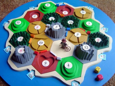

This is my first project on instructables. Hopefully some people will like it :). I based this on another project I found here on instructables. I drew these plans in inkscape so that they are now available for a laser printer.

Step 1: Step 1: Cutting All of the Parts
I've made the version for five or six players. If you prefer the smaller version, you won't need to cut out as many tiles.

Step 8: To Hold Everything Together...
Depending on what version you are making (for six players or four players) you'll need a different board to keep all of the tiles together. I've made these pieces from 9mm MDF, but that is optional. 4mm MDF Board will do just fine.
For the four player version:
The board will be completely hexagonally, so you'll need six of the same pieces. It's the one you see in the second pictures on the bottom (the smallest one).
For the six player version:
The board will be like in the first picture. You need four long pieces and two short pieces.

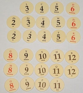

Step 10: The Numbers
We're almost done! We just need to make some circles with numbers on them. On the picture you'll see how you need to arrange them (the letters). This is important to guarantee that there won't be three sixes or three eights next to eachother (otherwise one player will have a big advantage over the others).
Just let the laser cutter do all the work ;-).
