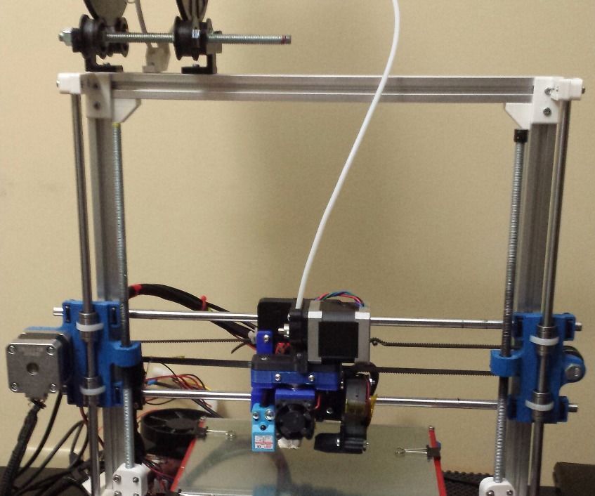

3DPrintMi is an open source, Reprap 3D Printer designed and built from the ground up. As part of the Reprap movement, it has the ability to self replicate by printing a portion of itself and assembled together with fasteners.
For more information, please visit the links listed below:
Summary
After building my first 3D printer, the Printrbot+, I wanted to donate aka "Print It Forward" a set of plastic parts and share the 3D printing experience to someone else. There are many Reprap printers out there, readily available to download and print but it's not as easy as it sounds. Most of the documentations to build a Reprap are hard to follow, incomplete or non-existent and can be simply overwhelming for a newbie. After weeks of searching for a suitable Reprap printer to donate, I became more and more interested in designing my own. Something that's easy to build, print and provide all the documentation to do it. After much debate, I decided to do just that, build my own printer. Well, after 6 months of printing, iterating and more printing, 3DPrintMi was born! I have built two 3DPrintMi so far and wish to see it built elsewhere around the world.
Getting Started
This guide will provide you the step-by-step instructions on how to assemble the printer's frame, assuming that the user has already pre-assembled the electronics before hand. I highly recommend you review the pictorial guide to get a good sense of what to expect. The pictures are self explanatory and the written instructions are there to aid the assembly. Now let's have some fun!

Step 16: Subassembly - Build Plate
There are two setups for the build plate, one for PLA only and the other for both PLA and ABS. Each setup will require pre-fabrication of parts to complete the build plate assembly.
PLA ONLY setup
Printing with PLA does not require a heatbed since it does not have the tendency to shrink and curl during a print. An aluminum or wooden plate can be used but will need to be cut down to 152mm x 152mm(6" x 6") and mounting holes drilled to fit on the Y Carriage. It is optional to install a glass plate on top for a flatter surface.
ABS & PLA setup
The PCB Heatbed is primarily used for ABS to prevent it from curling prematurely during a print but it can also be used for PLA by simply turning off the heatbed. This setup recommends the use of a glass plate and an insulation board.
For this setup, I use the PCB Heatbed/boriscillate glass plate as my build area. I prefer this setup because you do not need to perform any pre-fabricated work besides clipping the boriscillate glass' corners and simply cutting a piece of cardboard for insulation.
UPDATE 9/13/2013
Procedure to u pscale to 200mm x 200m (8" x 8") PCB Heat bed below
NOTES
- The PCB Heatbed should come with a pre-wired 100k thermistor, needed to measure the temperature.
- 100k thermistor should be secured with Kapton tape on the back of the PCB Heatbed, use thermal paste.
- Insulation material will need to withstand a temperature of up to 100 Celsius.
Materials
1 - 152mm x 152mm(6" x 6") PCB Heatbed
1 - 152mm x 152mm(6" x 6") Boriscillate glass (Need to clip corners to fit)
1 - Insulation board (optional)
1 - Sub-assembled Y Carriage
4 - Sub-assembled Knob
4 - M3 socket x 25mm
4 - M3 Washers
4 - Compressible spring
4 - Binder Clips
Procedure
1. Apply thermal compound and Install 100k thermistor on the back of the PCB Heatbed with Kapton Tape
2. Install Insulation board on the back of the PCB Heatbed, covering the 100k thermistor
3. Carefully clip all 4 corners of the glass plate
4. Place glass plate on top of the PCB Heatbed
5. Secure glass plate and insulation board with binder clips
6. Insert M3 Washers into each M3 socket x 25mm
7. Insert M3 socket x 25mm into the corners of the PCB Heatbed
8. Insert compressible springs to each M3 socket x 25mm
9. Install the assembled Y Carriage onto the PCB Heatbed and secure with assembled knobs
10. Insert 8mm drill rod to ensure smooth travel.
