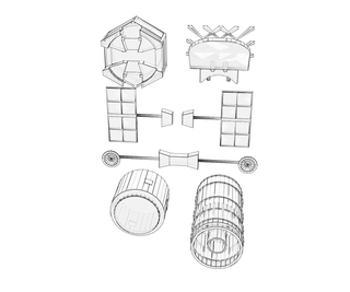

Step 1: Find a Drawing on the Internet
The first and easiest method is to find a drawing on the internet. Ofcourse you can use drawings from any site like thingiverse, but I, and i thing you to, want my drawings as authentic and realistic as possible.
So, we go to a site like: http://nasa3d.arc.nasa.gov, this is a site from the US governement where you can find 3D drawings of their satelites, telescopes and parts of the surface of mars and the moon.
Here I chose the hubble telescope which you can also find in this instructable.

Step 3: Prepare the Drawing for Printing
This is a very critical step, since this will seriously affect the look of our print.
- The resolution: These models are very complex, but, since the US governement can't publish exact drawings because of safety reasons, the drawings only have an average resolution. I used 100 micron, but you could go lower to 200 micron.
- The print speed: This kind of depends on what printer you are using, but keep it low. Especially for the first layers, otherwise some parts wil be riped of the print bed. I used 25mm/s.
- Support: You will definetly need support. Some parts will fall over without it.
- Temperature: This totaly depends on you and your printer. I used 200°C for the nozzle and 60°C for the bed.
