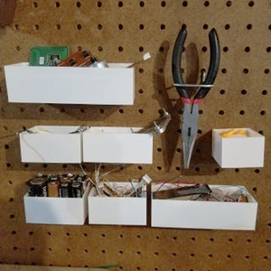

This Instructable will show you how I model and print these modular boxes that are compatible with any pegboard. The medium sized ones only take about one hour thirty minutes to print, take only 12 grams of filament, and can hold quite a lot of weight. You can download the files here on Thingiverse or in step #4.

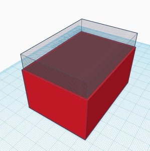

Step 1: Model the Box in Tinkercad
Place a normal box and scale it to 50 by 71.11 by 35 mm. Then place a "hole" box and scale it to make the walls .8 mm thick ( 69.51, 48.4). Then raise it .8mm off the work plane for the bottom. After you finish, group them together.

Step 4: Configure As You Please
Print out more and make them useful! This systems modularity and compatibility allows it to be configured in an infinite amount of ways. Thanks for reading all the way to the end! =)
