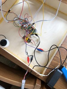

Step 2: Wire Up the Board
You are going to need to wire up 5 external buttons, a touchpad sensor, and a speaker to your Pico W and match the input signal wiring to that of the code.

Step 4: Create Your Board
When your prototype looks good, go ahead and cut it with wood! Insert the buttons to your board. Similarly, add copper tape that will act as your touchpads, and alligator clip those patches of tape to your touchpad sensors. The laser cutting files that I used are attached.
