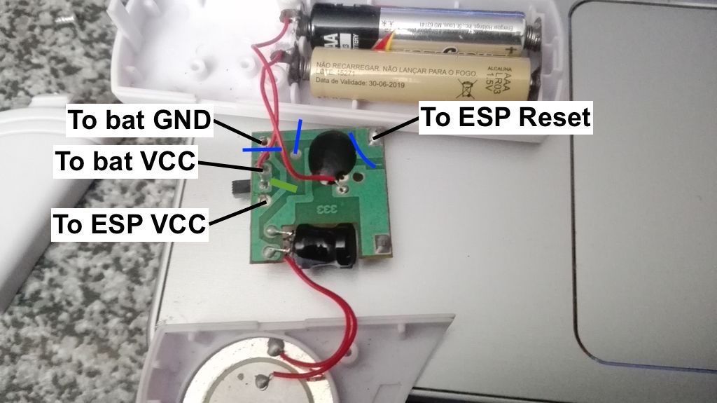

Step 6: Hack the Door Alarm Hardware
Open the door alarm enclosure and do some hacking:
- Remove the flat speaker
- Remove the autotransformer
- Isolate the alarm chip by cutting the tracks on the printed board
Solder the following connections:
ESP8266 pin | Door Alarm pin |
GND | Battery holder GND |
VCC | Power switch output |
RST | Reed sensor |
Additionally do the following:
- Connect the second pin of the reed sensor to the battery holder ground
- Connect the battery holder 3.3V wire to the power switch input
- Wrap the ESP8266 in some electrical tape to prevent shorts
I recommend to do some tests before putting everything back in the enclosure:
Put 2 AAA new batteries in the slots.
When the RST pin is connected to GND it disables the ESP8266, this is why we need a pulse rather than a falling edge. To trigger a wakeup just bring the magnet close to the reed sensor and then back it off. Verify that you receive the alert. If you don't: check your wirings.
Once your tests are conclusive try to pack everything inside the original enclosure and screw the cover back on.
In the next step I will show you how to simulate the pulse when the door opens.

5 years ago
Hi, i'm new to eletronics, and i like this post, but my sensor is a little diferent, i can´t cut the chematic in the same way (as photo 3), can anyone help with the wiring for ESP8266 in the image layout.. or if i need to do some cuts in the circuit,
Thanks;
Reply 5 years ago
Hi,
Here is a graphic explanation. I hope this helps. Feel free to ask for more help/details!

I forgot to mention that you need to cut the circuit on the blue lines.

Hi, thanks for your time to analize, see the attach with other side... i don´t understand one thing, the "to BAT GROUND" and "to ESP VCC" in the layout are the pins that support de button... is that the correct connection??
I send the photo of the button too.
Thanks..
Reply 4 years ago
you can use it, you have that gig blck round thing! it is a inductor, and works exact the same as an reed switch my friend.
i bet that black thing was at the sensor side where the magnet most touch it for the alarm...? eeh....
Reply 5 years ago
Hi,
You are right, don't connect it as I told or you will make a short circuit :D
Your plate is quite strange, usually there is a bulb with 2 close wires inside, this is the reed sensor. In your case the bulb has been omitted. I don't even know how if the original alarm would work this way.
I added a cut to isolate GND and VCC. Do not cut the one at the bottom, I covered it with green line.
Good luck.
Reply 4 years ago
i think it would work, he has an inductor as a switch, that is an magnetic switch i think. or he must FOR CONVEIANCE buy our alarms that we all used heree from aliexpress for 1 USD.

Could you post a photo of the other side of the board please? I want to double check, I suddenly had a doubt about one thing.
