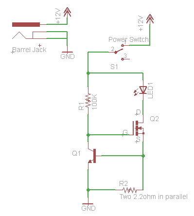

Step 2: Build and Test the Circuit
It is advisable to mock up the circuit on a breadboard before soldering it onto the PCB. That way you don't frustrate yourself. After you solder the circuit to the PCB, be sure to check that it still works. If your barrel jack is of the kind that is case-mounted rather than PCB mounted, be sure that you solder the leads to it, but do not solder the leads to the PCB yet. The same goes for the SPST switch. That will be done during final assembly.
These LEDs are cheap, and we want them to last a long time. Therefore a circuit is implemented to protect them. The circuit itself is common sense (well, for electrical engineers anyways), and simple to understand. R2 is a current set resistor. When excessive current passes through Q2, R2 redirects the current to activate Q1, which then turns down Q2. For this particular string of LEDs, R2's value should be 1.25 ohms at 1/2 watt. Unfortunately, there is no resistor at that value. In order to get close, two 2.2 ohm resistors are placed in parallel to get 1.1 ohms. Close enough. For more detail on these types of LED control circuits, and how to calculate them, refer to this Instructable. Dan provides some in-depth explanation on their design and implementation, as well as some excellent ideas for other circuits.
After all the testing is over, remove the leads from the LED strip. Do not use prolonged heat as the strip is made of plastic. Next cut the one meter strip into four equal strips. There are separation points every two inches that have copper solder tabs. The polarity is marked on each separation point, so don't worry about keeping track of that. After cutting, tin the solder tabs. If you are unfamiliar with what tinning is, it means to apply a small amount of solder to the surface. Now remove the curve from each strip by bending it so that each will lay flat, and lay the strips side by side. Cut some short pieces of wire, strip their ends, and tin them. Use these pieces of wire to solder the LED strips back together as seen in the last photo. Because everything is tinned, extra solder shouldn't be needed. Make sure to match the polarity as marked on the strips.
