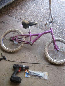

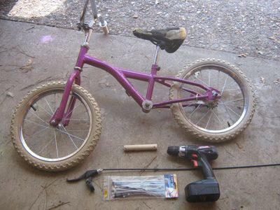

For this Instructable you will need the following materials
-a bicycle
-a cordless drill (any voltage will work but the bigger the better. I got mine from harbor freight for $15.)
-lots of zipties (how many you will use depends on your type of bike and/or drill)

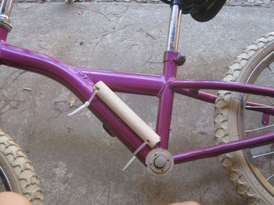

-a piece of small wood ( this will support the drills' battery)
-a bicycle hand brake ( this is for the throttle system)
-bicycle cable ( this also for the throttle system and goes into the hand brake)

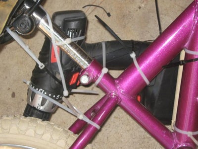

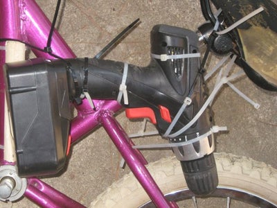

Now begin to ziptie the drill onto the bicycle frame. Make sure that the drills' chuck always stays on the side of the tire. Try to keep the drill in line with the tire. Get the drill as snug AS POSSIBLE against the side of the tire. The more friction you have the better the drill will grip the tire.

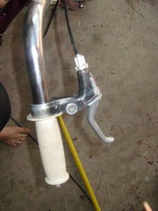

Combine the hand brake an the cable and the slide the hand brake on to the handlebars of the bicycle. This will probably require removing the handlebar grips. Finally, tighten down the hand brake.

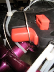

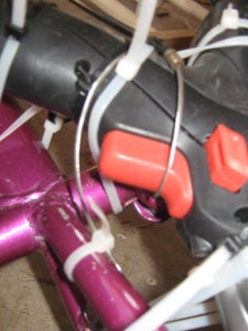

Beware this is the hardest part of the instructable. Take the bicycle cable and lead it down to the side of the drill where the trigger is. Ziptie the end of the black part of the cable to the SIDE of the drill. Wrap the metal part of the cable around the trigger and back to the side of the drill. Ziptie the black part of the cable and the end of the metal section of the cable together. Make sure that the cable does not pull on the trigger. It should only pull on it when you pull on the brake handle. You can skip this step and just pull the drills trigger with your hand. however you have to drive with one hand.
