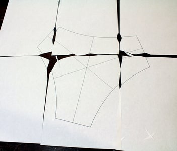

Step 4: Assemble Your Print
After the paper comes out of your printer you will have to assemble the pieces together.
The first photos shows how the pages looked immediately after I removed them from the printer.
If you look closely at the print you will notice that there is a small margin between the end of the printed lines and the edge of the paper. This margin makes it very difficult to precisely align the pages together.
It is much easier to assemble if you remove the margin first. I remove the margin by cutting right up to the end of the printed lines with a pair of scissors. The photo with the very large gaps between the sheets shows how the pages looked immediately after I trimmed the margin.
The last photo shows how the print looked after trimmed the margins and taped the pieces together.
