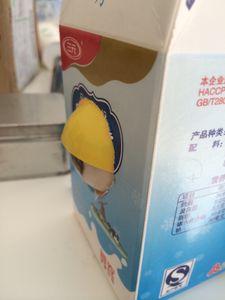

- The internal structure is shown in the first pic. I use 2 motors to control xy directions, X: eyes left & right Y: eyelid up & down. I use PVC plastic strip as an transmission structure.
- Screwed the L shape & other plastic supports tighten together like this.
- Note: The foremost 2 tapping Screws are for locking up the eyelid, above on the left & right yellow strips

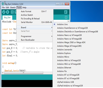

Step 7: Part 3: Code
- Board selection: Tool—Board—Arduino Uno (or Microduino both available)
