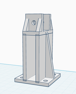

Step 1: Design
In the first step, I designed as much as possible in Tinkercad. This was very useful to check if the parts would fit. In the photo, you see a preliminary stage of the design process. Notice that the 2040 profile is not used at all in the final product!
In the other photo, you can see almost all the printed parts. The gantry plate on the left was not printed; instead, I cut it out of 7.8mm acrylic. However, if you don’t have access to a laser cutter, you can use the STL file to print it.
As a "just-in-case-you-need-them" thought, I made 12 holes on the edges of the gantry plate and tapped M4 threads into them, so you can bolt things to it later if needed.

Step 6: Foot Supports
Attach the four foot supports with 2 bolts per foot on the 2020 profile as shown. On photo 1 you can see where I put them.
You probably cannot modify the STL file via ungrouping it. If you need to alter the height of the supports, you can do it like this, in Tinkercad:
  1. Make 2 copies of the model.
  2. Create and position 4 see-through blocks as shown in photo 2.
  3. Group each part separately, as shown in photo 3.
  4. Adjust the height of the stem (an exaggerated height difference is shown in photo 4 for clarity).
  5. Align the parts and position the top section at the correct height, photo 5.
  6. Group everything together and print.
