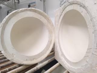

Step 1: Make a Plaster Mold
You will need plaster, water and a large bucket to create a mother mold.
The first step: Pour 1kg of plaster into a bucket and add a cold water 1: 1.5 ratio.
The second step: Let them sit in the bucket for 2minutes and mix them well.
The third step: let them sit for over night until get hard and dry.

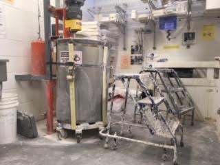

Step 2: Mix Slip Porcelain
Pure the porcelain and water into the porcelain mixer for 3 hours and pure the porcelain into the plaster mold.

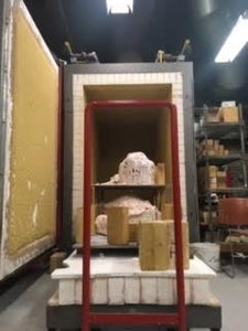

Step 3: Into a Kiln
Prepare the kiln setting and load the egg base into a 6 feet hight kiln. This process will take a 2days to heat and cool down the egg. It is very important to set it slow mode in cone 05 or 06.

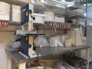

Step 4: Shape the Egg
Once you have the egg shape out of the kiln and need to be shaped or sanded.
You can use a table saw or sand blaster to get a right shape.
