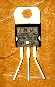

    9) LM317 (Adjustable voltage regulator IC). (Here's the RadioShack link)

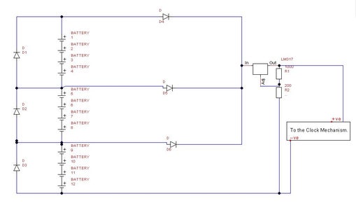

    The technical part is pretty simple. LM317 IC has the output of 1.25*(1+ r2/r1 ) {see Pic-3). Thus, with r=200ohm, r1=1kohm, the output should be exactly 1.5V.
    Now, here's a catch: one could easily connect all the twelve batteries in series, and forget about using any sort of diodes or anything. But then this arrangement has two major disadvantages:
    1) All the twelve cells are required at once. A single cell less, and the clock won't work!
    2) Since the 'empty' cells, all won't have the same voltage and would most probably be dissimilar, it may lead to cells to leak (and believe me, it won't look good!).
    One cannot altogether skip th second disadvantage, but I came up with this solution:
    I decided to group the cells in a group of fours (three groups in total). This way, at a given time, the clock could work even with as few as four cells. In case all the 12 cells are connected, according to the schematic I've used, they shall all be in
    The circuit is all connected as shown in the schematic (the detailed one). Please note that the ground shown in the schematic is actually used as the negative connection. In case you find errors in the circuit, do inform me about them. In case of any doubts, just comment below.
