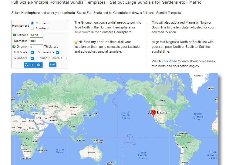

Luckily for us there are sites like this one Sundial Calculator that lets us simply select our location on the map and it does all the hard work for us.
My sundial is made for South Africa that is 27 degrees latitude and in the southern hemisphere.
After selecting your location on the map it will give the results as shown above, you can then go ahead and download the example as an SVG file straight from the site to use in your design.
Attached below is the SVG file for my sundial, you can use it and simply adjust the hour positions to the ones shown for your location.

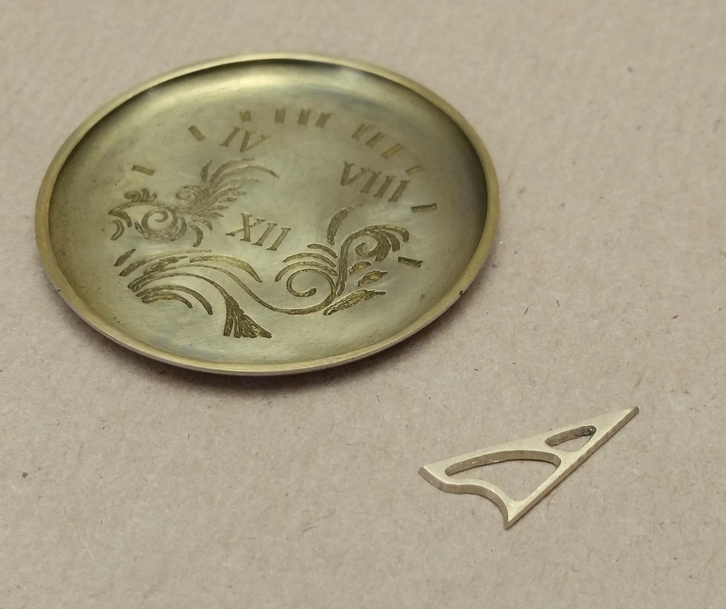

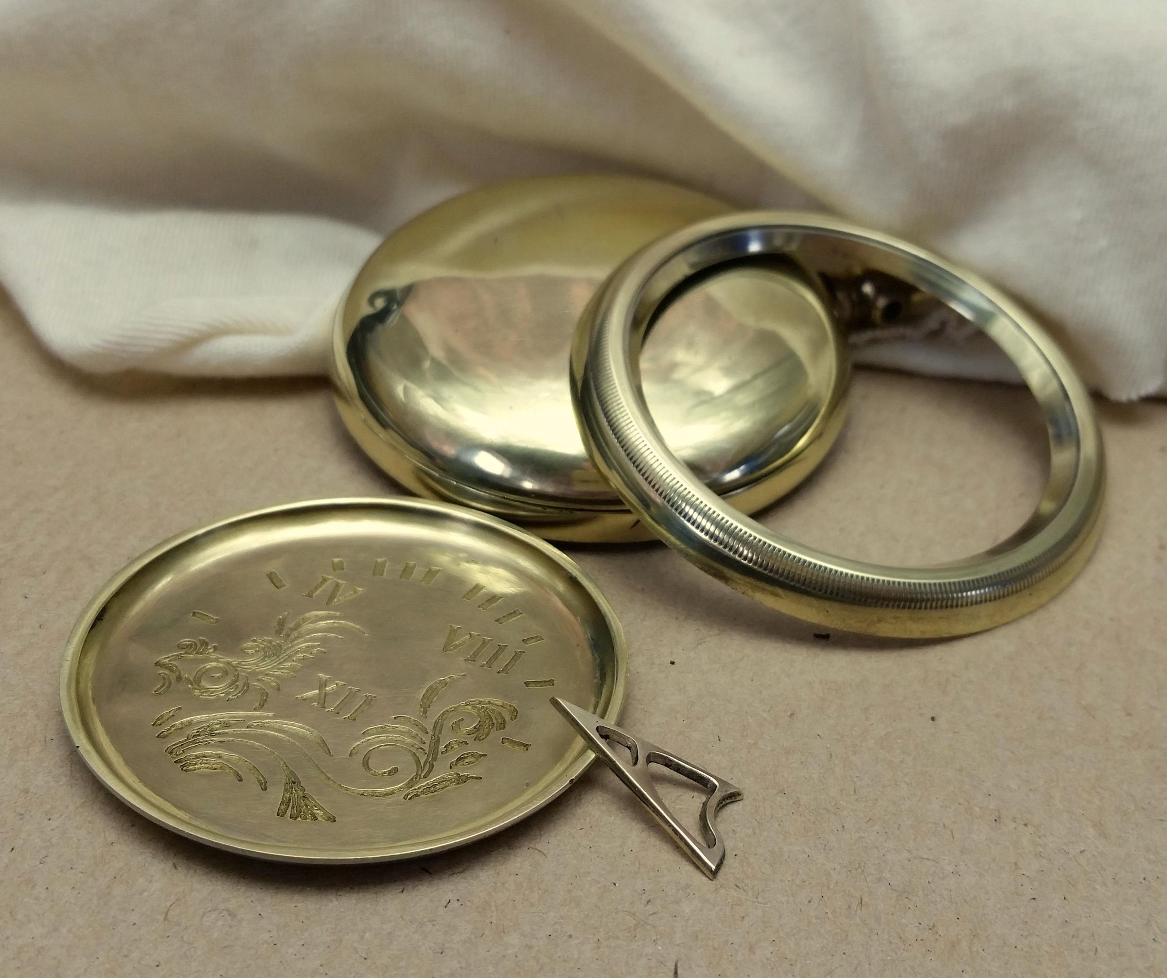

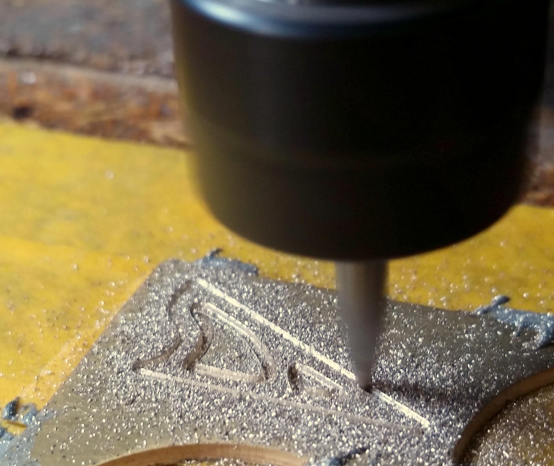

I used my home built CNC machine to engrave the design onto the brass plate, as this is a non ferrous metal it is easy to engrave with inexpensive small desktop CNC's.
To hold the piece in place to engrave I stick painters tape on the work bed of the machine as well as on the back of the work piece, this allows me to stick the work piece onto the bed using CA "super glue" and easily peel it off when done.

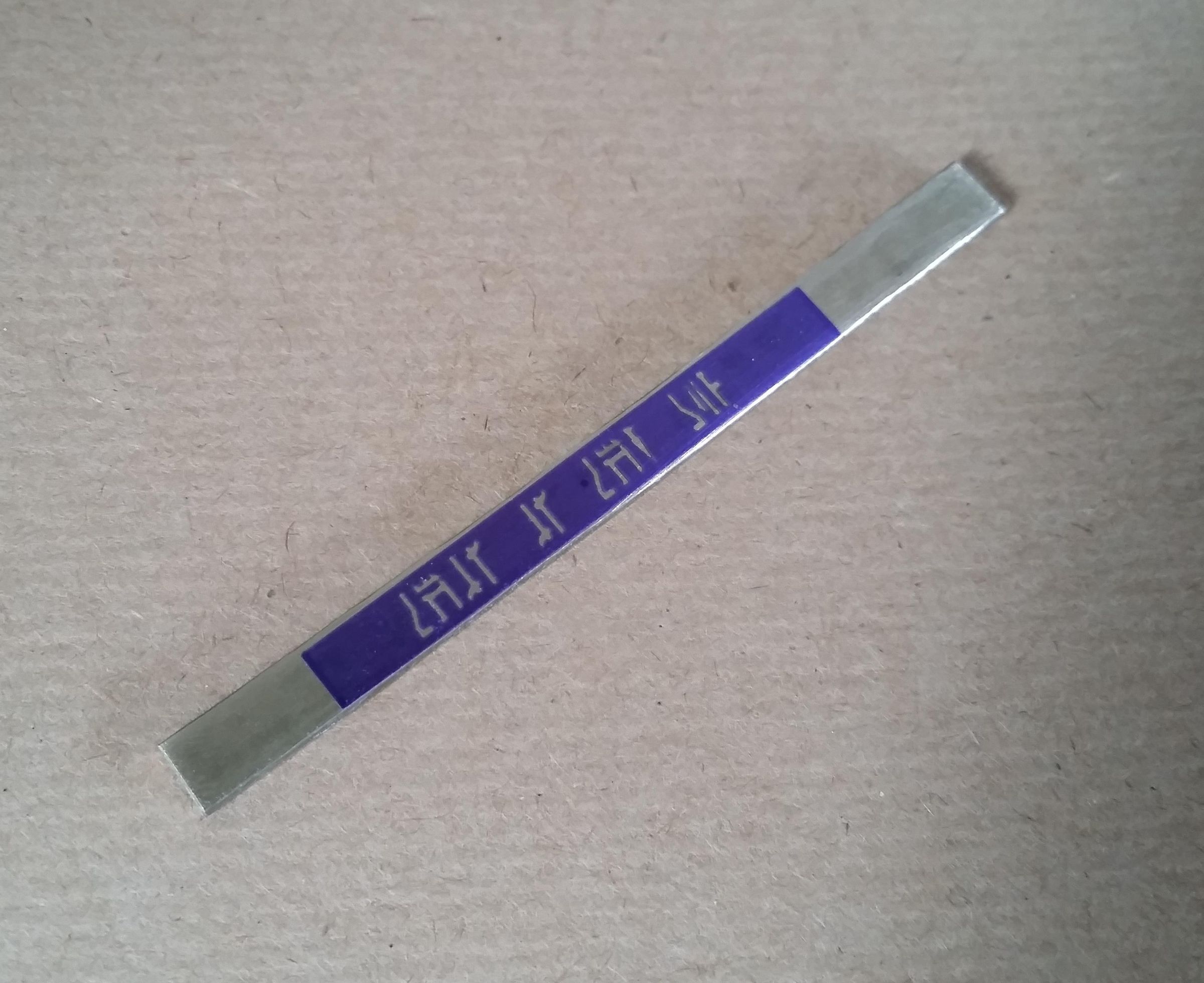

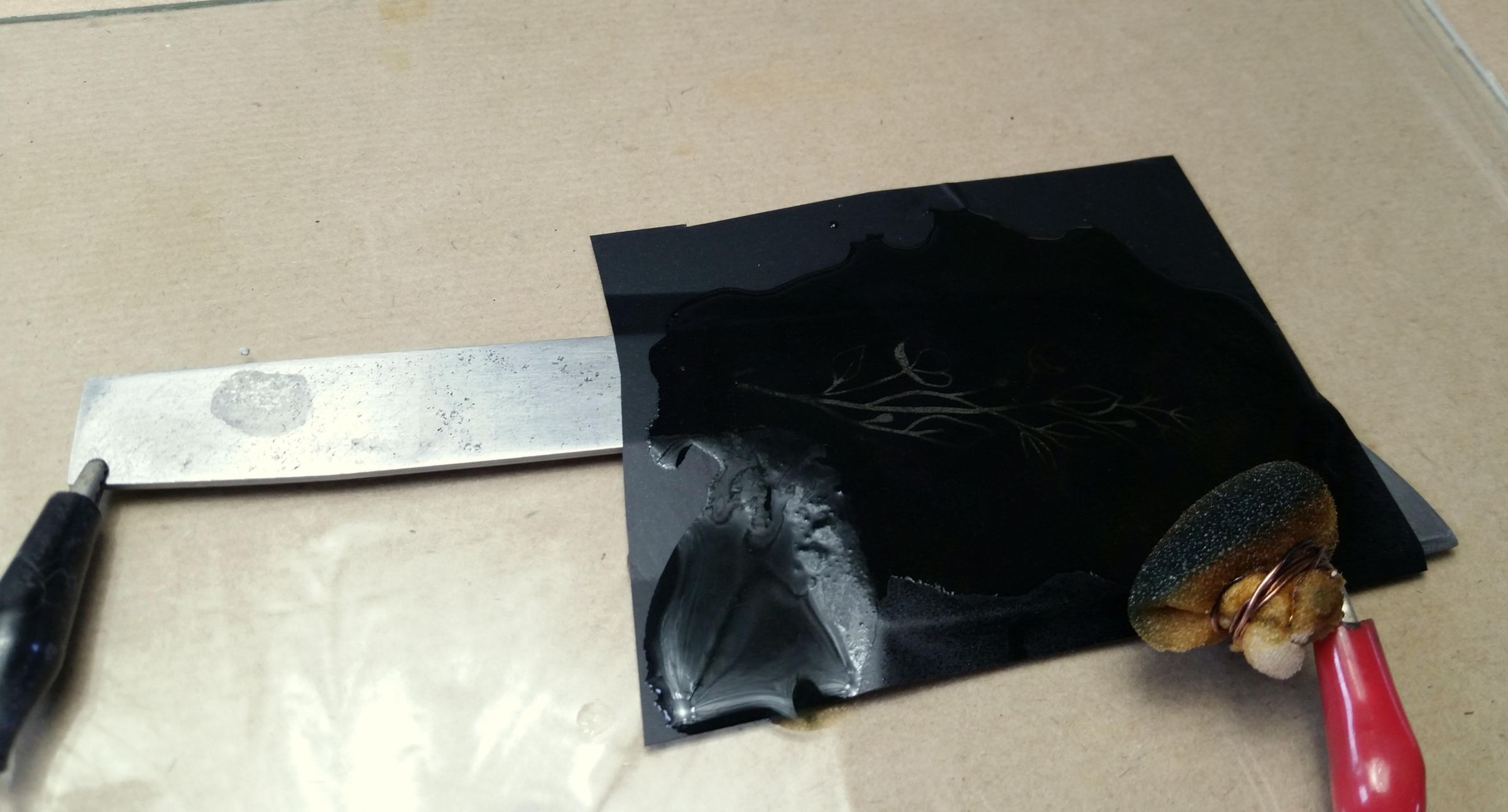

  • Sticker and salt water etching.
In my Instructable "Turn an Old Saw Blade Into a Kamagata" I show how you can get a beautiful etching with a lasercut/Cricut sticker followed by salt water electroetching.

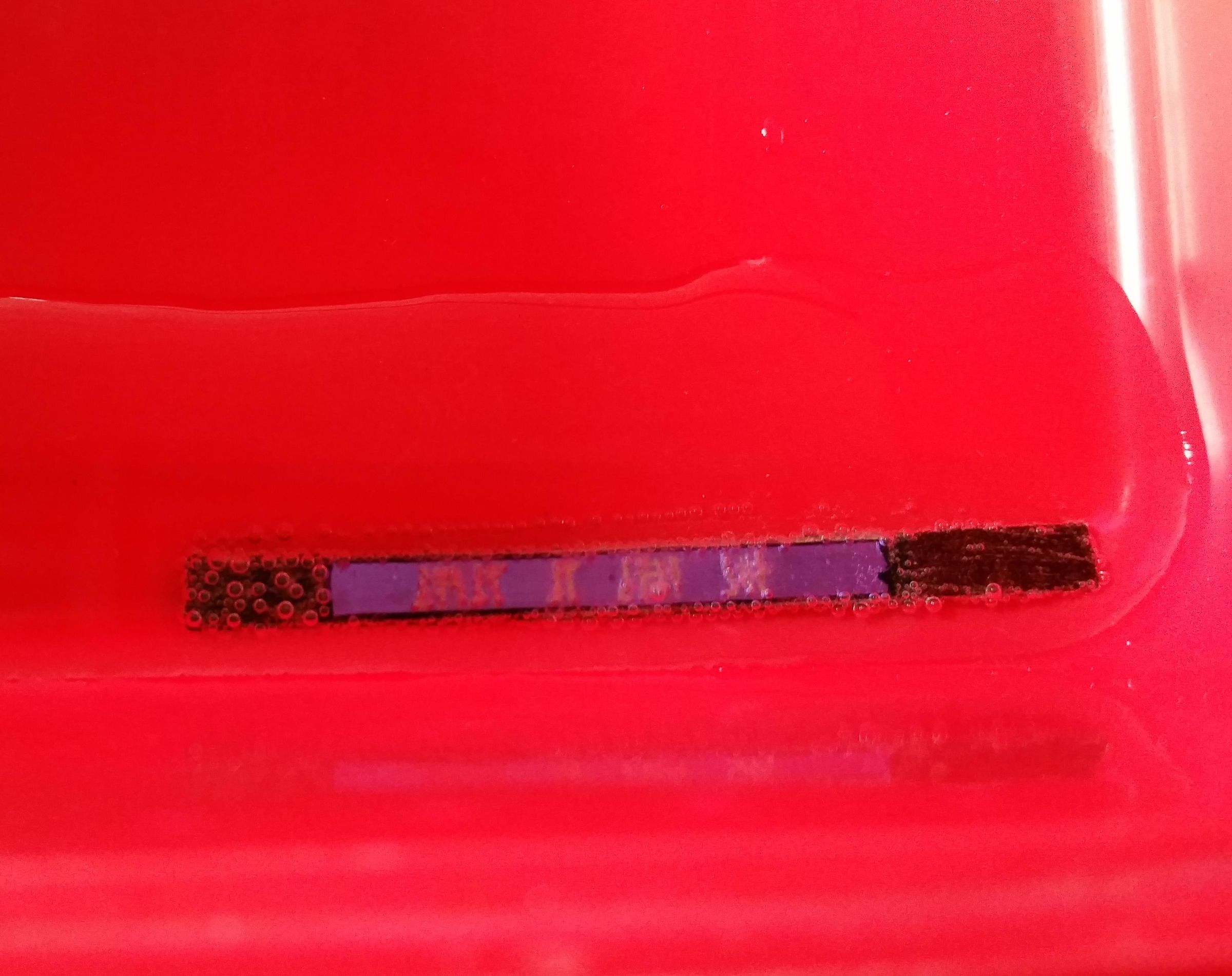

  • Photoresist with acid etching.
In my Instructable "This Is the Way... Hand-forged & Etched Ring" I use photoresist film that is usually used in PCB manufacturing to acid etch a design into metal. the design can be hand drawn and doesn't require any other machines just the photoresist film and our good old sun to expose it.

Step 6: The Gnomon
The gnomon is the centre piece that looks like a sail, this casts the shadow onto our sundial to indicate the time.
We use the measurements given by the site in Step 4 to design the gnomon you can get creative with this as much as you like as it is quite a prominent piece of the sundial. The most important thing is to stick to the dimensions and angle given by this as it will determine the accuracy of your sundial.
I cut mine out of a 1mm thick piece of brass plate on my CNC.

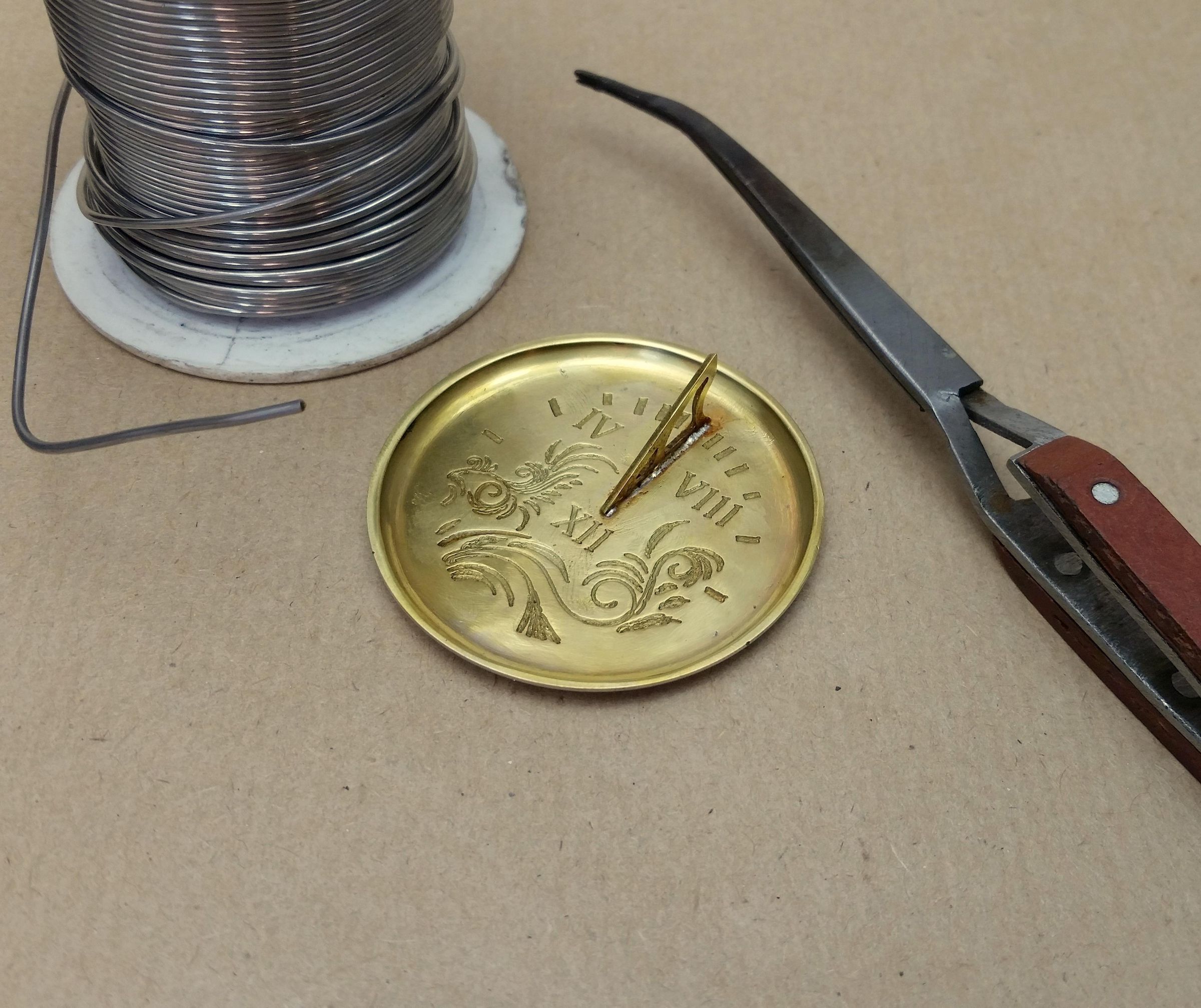

Next we need to solder the gnomon onto the face of our sundial.
For this I used normal tin solder (the same as used with electronic soldering) as it is readily available and easy to adjust if something goes wrong....my first attempt was VERY skew!
Simply heat the gnomon with a soldering iron or heat gun (holding onto it with tweezers) and melt a small bead of solder onto the bottom edge of it.
Now position it onto the sunface dial making sure of the true north/south position as shown in Step 4, heat the entire face until the solder melts and the the gnomon is affixed.

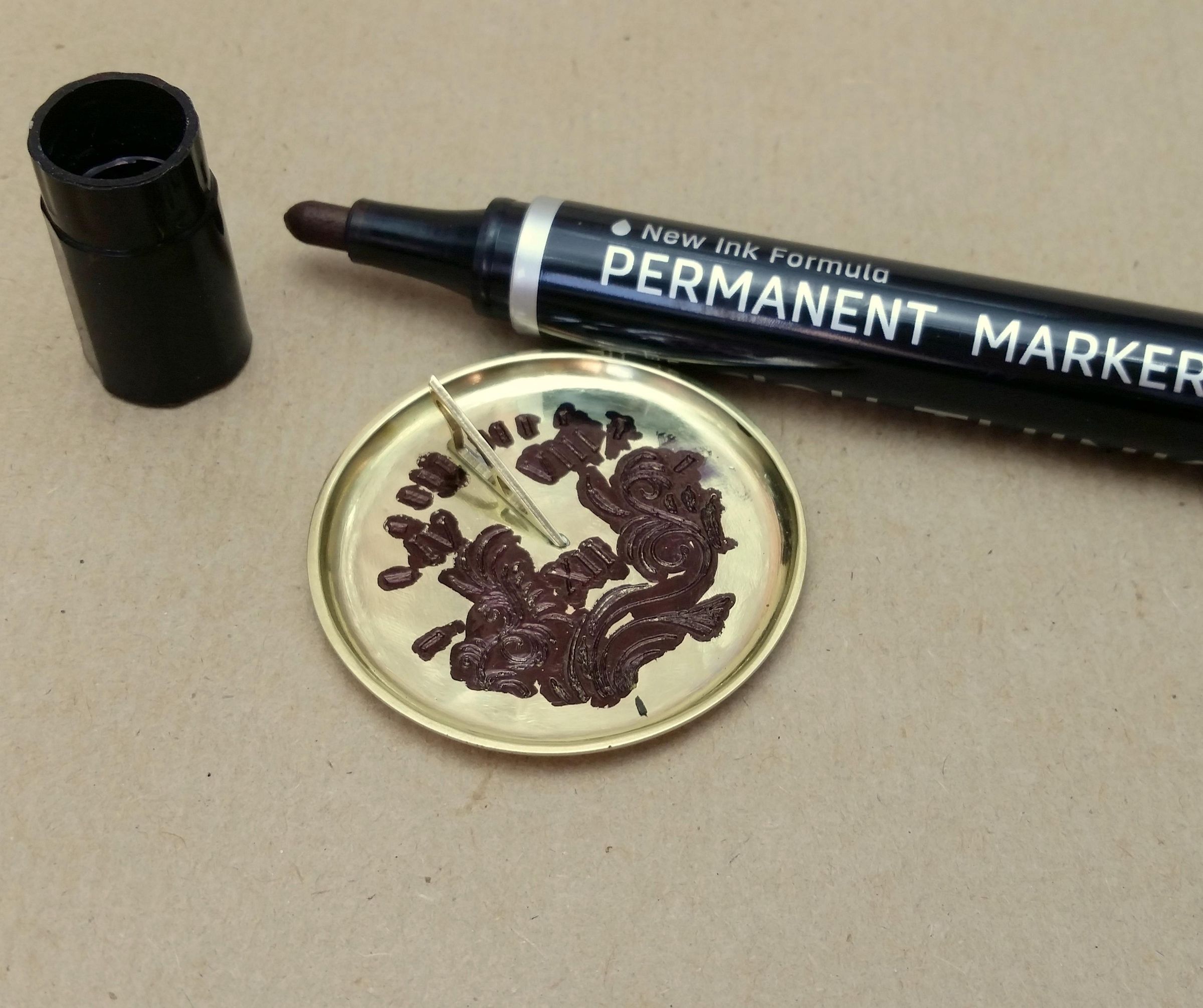

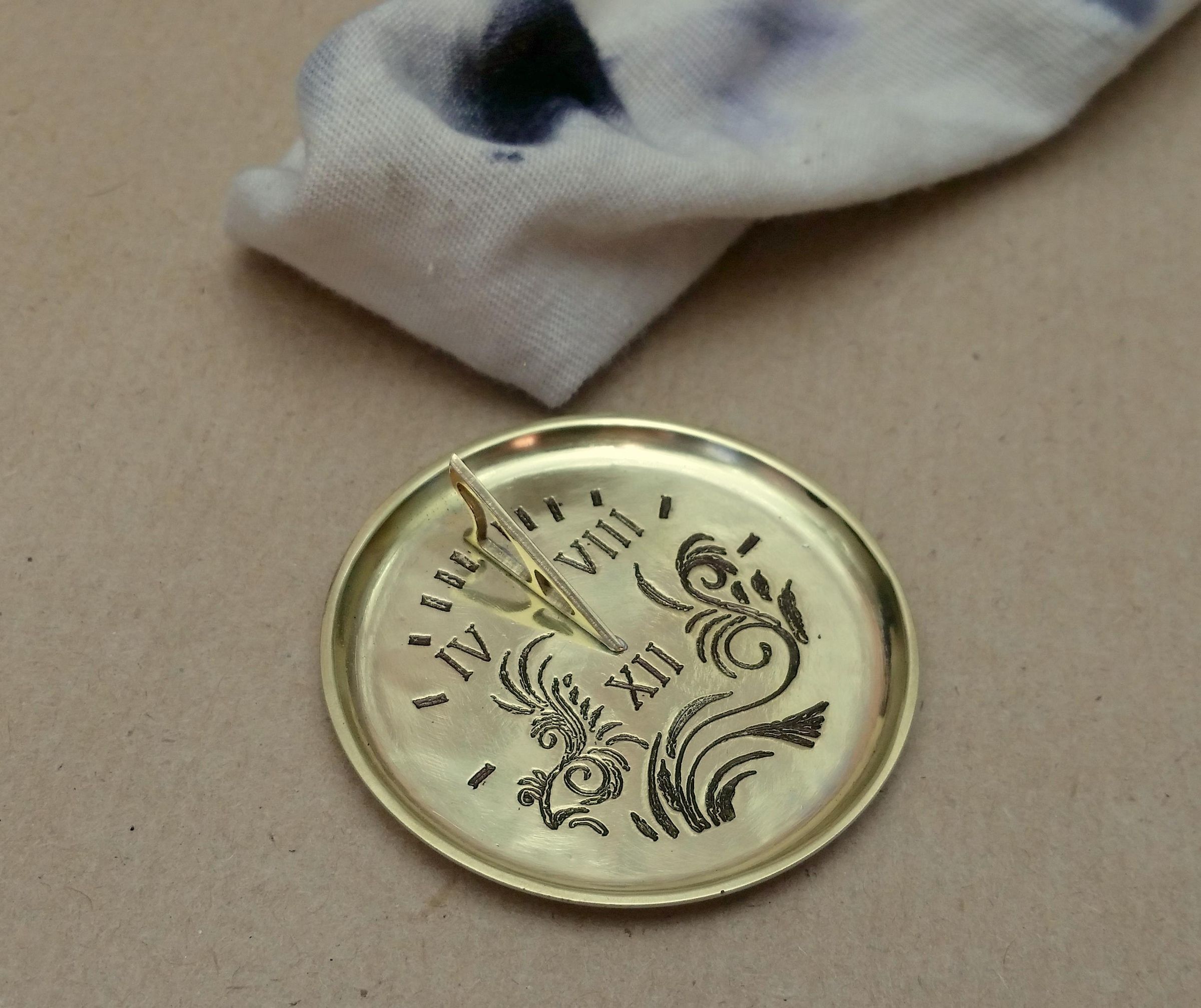

To make the engraving on the sundial stand out more I used a black permanent marker and coloured in all of the engraved areas and left it for a few minutes to dry completely.
After the marker has dried you can used a slightly damp cloth stretched over the tip of your finger to wipe away the excess marker. Use an old cloth as it will be stained.
Instead of the marker you can also use thin paint/nail polish to fill in the engraving but personally this is a lot more work and the results are not always perfect.

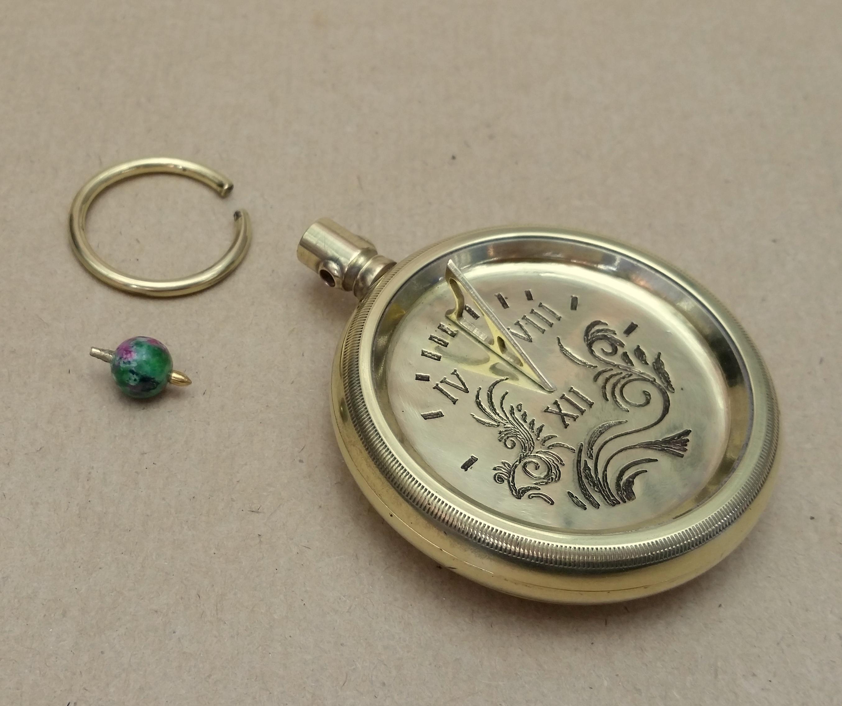

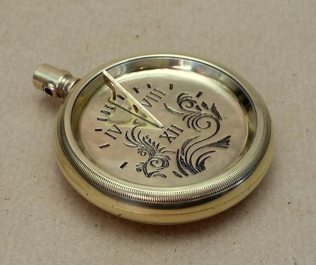

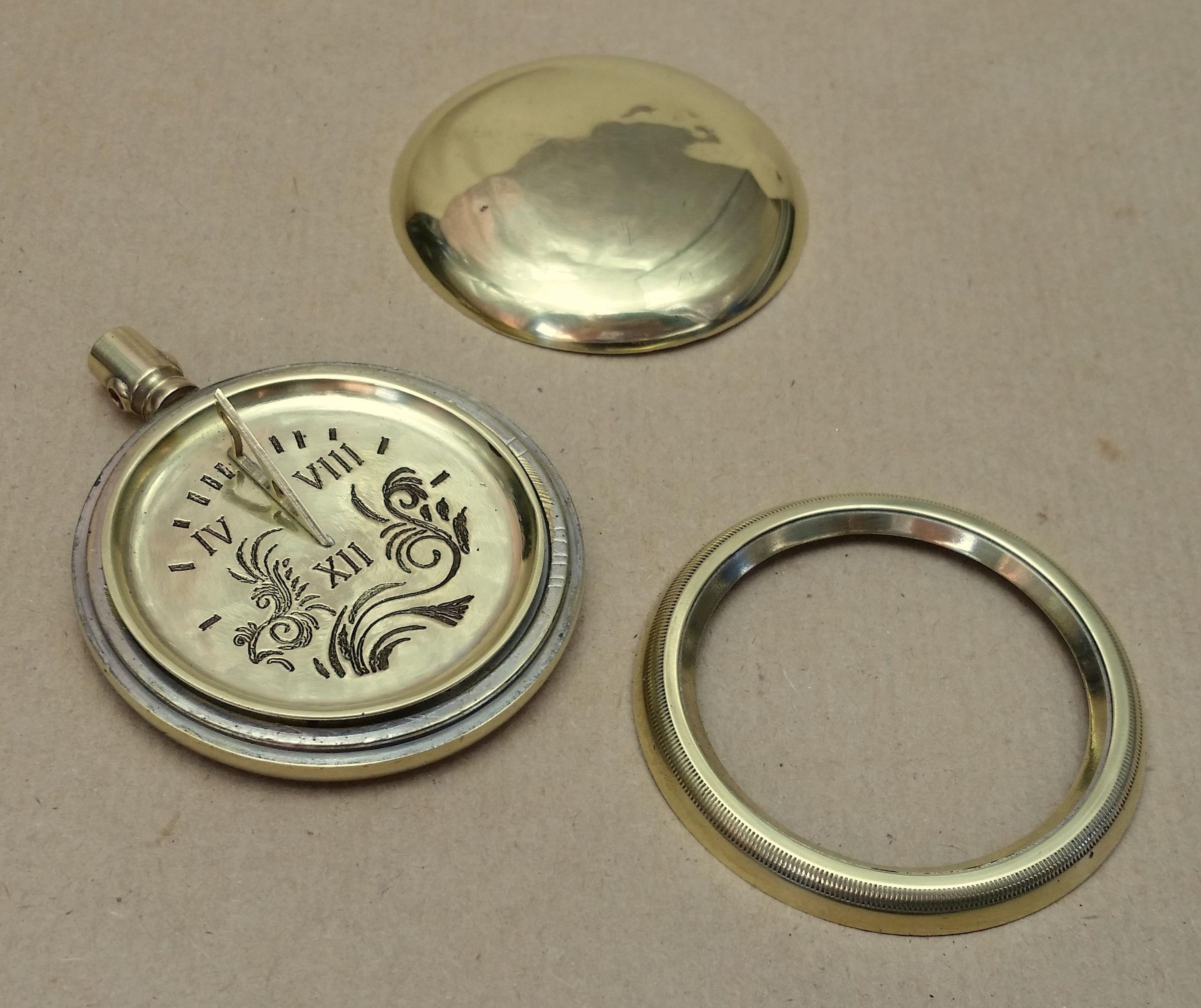

Step 8: Assembling Your Pocket Sundial
Now for the last step, assembling your pocket sundial.
I first needed to enlarge the middle piece of the pocket watch body slightly with a deburring tool as my sundial face had rounded edges and it didn't close properly but if you are using a flat brass plate this will not be necessary.
Further assembly couldn't be any easier you simply have to screw on the front bezel and back plate.
And finally you can clip in the bow (I swapped mine for a slightly bigger one than the original) and attach the crown, unfortunately the old watch I started with no longer had it's original crown as the repairers usually remove it with the clock movement so I replaced it with a beautiful ruby fuchsite bead held it place with some 2-part epoxy glue.
