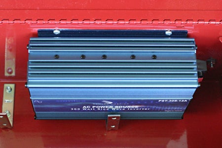

Mark and drill holes for the inverter and the inverter ground bolt. Remove any paint from around the holes so there is a good electrical contact.
Step 2: The Inverter
If you don't use a pure sine wave inverter, you will risk damaging your strobes. Some modified sine wave inverters are deliberately mislabelled and sold as pure sine wave inverters.
Attach the inverter with bolts and lock washers. Whatever surface you mount the inverter on, it must be horizontal or the internal fan will not work properly. Use the stripped electrical grounding wire to attach the inverter ground connector to the tool box ground bolt. Ideally the grounding wire should be 6 gauge, but it's difficult to work with anything that large in a small space.
I've heard rumours that Samlex  has significantly changed the design of their inverters since I built the power box. I have not tested these new inverters, but it would be interesting to know how well they work.  Update: The new 300 watt Samlex inverters are unusable. They now automatically shut down under stress.
The inverter company Samlex has stated that when building power boxes the inverter's surge rating should be four time the watt rating of the strobe. A 300 watt strobe would need a surge rating of 1200 watts, which matches the surge rating of  a 600 watt Samlex inverter.

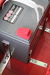

Place the battery in the box to check spacing. If I did it again, I would mount the inverter facing the other direction on the left side of the box, so that the power switch is at the top and easily accessible.

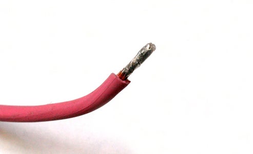

Use braided 8 AWG wire instead of stranded. It is much more flexible and will put less force on all the connections. SOOW 8GA cable has several braided wires inside and is relatively inexpensive.
Tin the ends of the cables and solder/torch on the battery connectors. Use full sized battery connectors. Smaller sized connectors can limit the maximum load by over 400 watts. I was unable to find the appropriate inverter connectors, so I tinned and shaped the wire with pliers so they would fit inside the inverter power sockets.

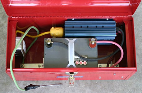

The circuit for the power box is:
battery positive --) breaker--) inverter positive
battery negative --) inverter negative
Drill bolt holes and zip tie holes in the flat piece of plastic. Solder on the positive battery cable to the breaker with a 100w soldering iron. Attach the breaker output cable to the inverter. Bolt and zip tie the breaker to the side of the box.

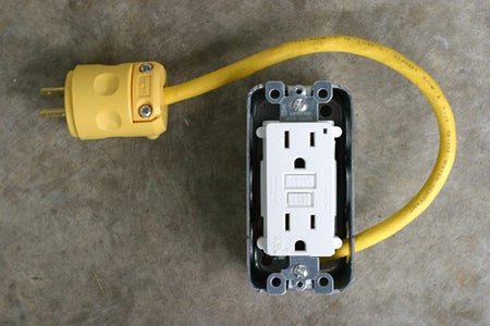

Step 6: Ground Fault Circuit Interrupter
A GFCI is designed to instantly cut power to the outlet if there is a short. When shooting outside you will get rained on, so a GFCI is essential.
Assemble the GFCI in a housing according to the instructions. Attach the end of an old extension cord to the GFCI and test it to see if the reset button is working properly.
Make sure there is enough space in the tool box to easily plug cords into to the GFCI after it is bolted into place. Remove paint around bolt holes for a good ground. Plug the GFCI into the inverter.

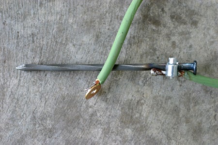

Step 7: Ground
A ground spike may not be necessary/usable under all circumstances, but it adds an additional layer of protection. In the event of a short, it will hopefully channel the current harmlessly into the earth.
Tin the ends of a 8 gauge cable. Solder one end to a brass washer and hose clamp the other to a large nail or spike. Electrical tape the hose clamp connection and bolt the washer to the left 3" angle bracket.

Portable Power Box Setup
1. Push ground spike into the earth (If possible)
2. Attach negative cable to battery
3. Turn on breaker
4. Attach positive cable to battery
5. Turn on inverter
6. Turn on strobes
Always connect the positive terminal last, so that any arching occurs on the cable that is protected by the breaker. When the positive cable is disconnected, do not allow it to touch the metal box. Turn the breaker off first. Some people have reported that the capacitors in the inverter can still hold a charge and can feed voltage back through the battery cables.
Turn off all the strobes before turning off the inverter. Do not store the power box with the battery connected. The portable power box with a 33AH battery will run two 600 watt strobes (not at maximum settings) for over 210 flashes. I have not yet drained the battery shooting under normal conditions.
