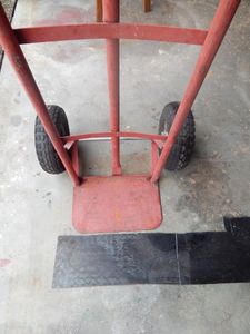

  • Steel plate large enough to overhang the trolley's base by about 50mm each side (see the picture above). I used 2.1mm chequer plate because that's what I had at hand.

  1. Mark the steel plate to allow 50-60mm overhang on each side of the foot of the trolley (I'm guessing it's called a foot) as pictured.
  2. Cut out the steel.
  3. Mark the width of the trolley on the steel as shown.

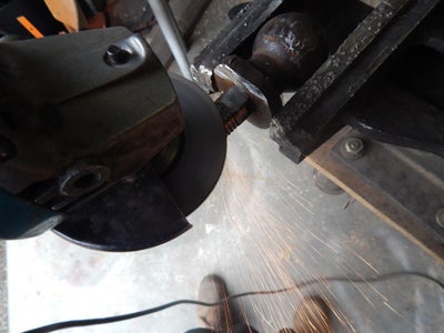

  9. Grind this area in preparation for welding.
  10. Grind a flat area on the threaded post of the tow ball were it is to contact the steel plate, and prepare it for welding.

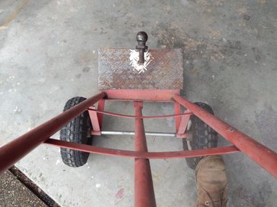

  11. Weld the tow ball into position as shown.
Step 3: Conclusion
Simply slide the adapter over the trolley as shown, and you have a trailer dolly. It's pretty straightforward, but see the video to see how it works.
