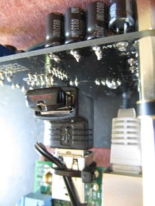

Step 4: Building the Player
The player was build to fit under a glas dome all components are mounted on vulcan fibre plates.
Please have a look at the pictures how its mounted together.
Some words about temperature:
The tubes are producing some heat but I measured only 32 degrees C under the glas dome.
The upper vulcan fibre plate protects the RasPi from the heat.
