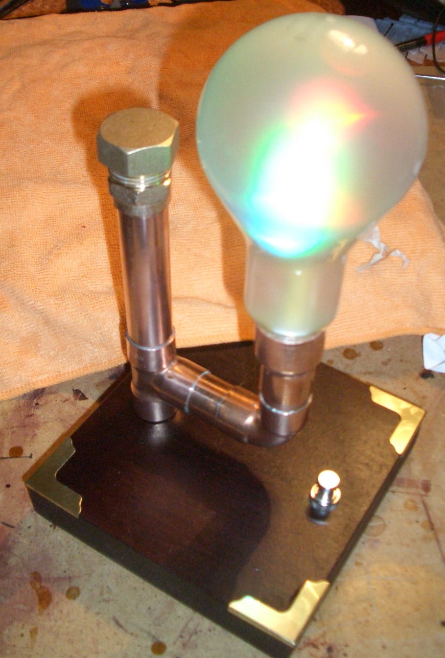

Step 3: Put It Into a Case or Build a Stand
You can put it into a nice case and hide the cables and batteries under need the velvet or you can build a wooden stand with some copper tubes and fittings.
To do so you have to prepare a base plate.I used "Multiplex".
I drilled a hole for a switch and on hole for a copper tube (22mm).
I used wax stain to stain and polish the wood.
Than I soldered the tubes and fittings together, polished them.

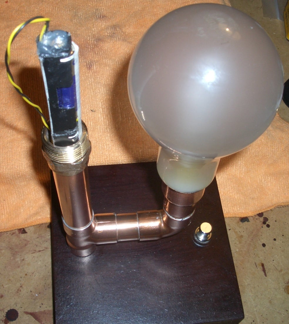

The long tube will be the battery case.
Step 4:
I glued the bulb into a fitting and attached the polished copper holder inside the 22mm hole.
With some hot glue I insulated the battery holder and it fits exactly inside the copper tube.
The cabling is very easy. Just from the battery holder to the switch and then to the bulb.
The switch it on....
