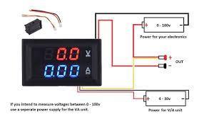

Step 4: The Volt/Amp Meter
this is the volt amp meter this is used to show additional information like output voltage , current , and total wattage
in the above pictures the second one is the most commonly available and used but if can get hands on the first one which has a wattage reading its a good deal but the wing for both is same
watt = volt*current that's all the first one has.
