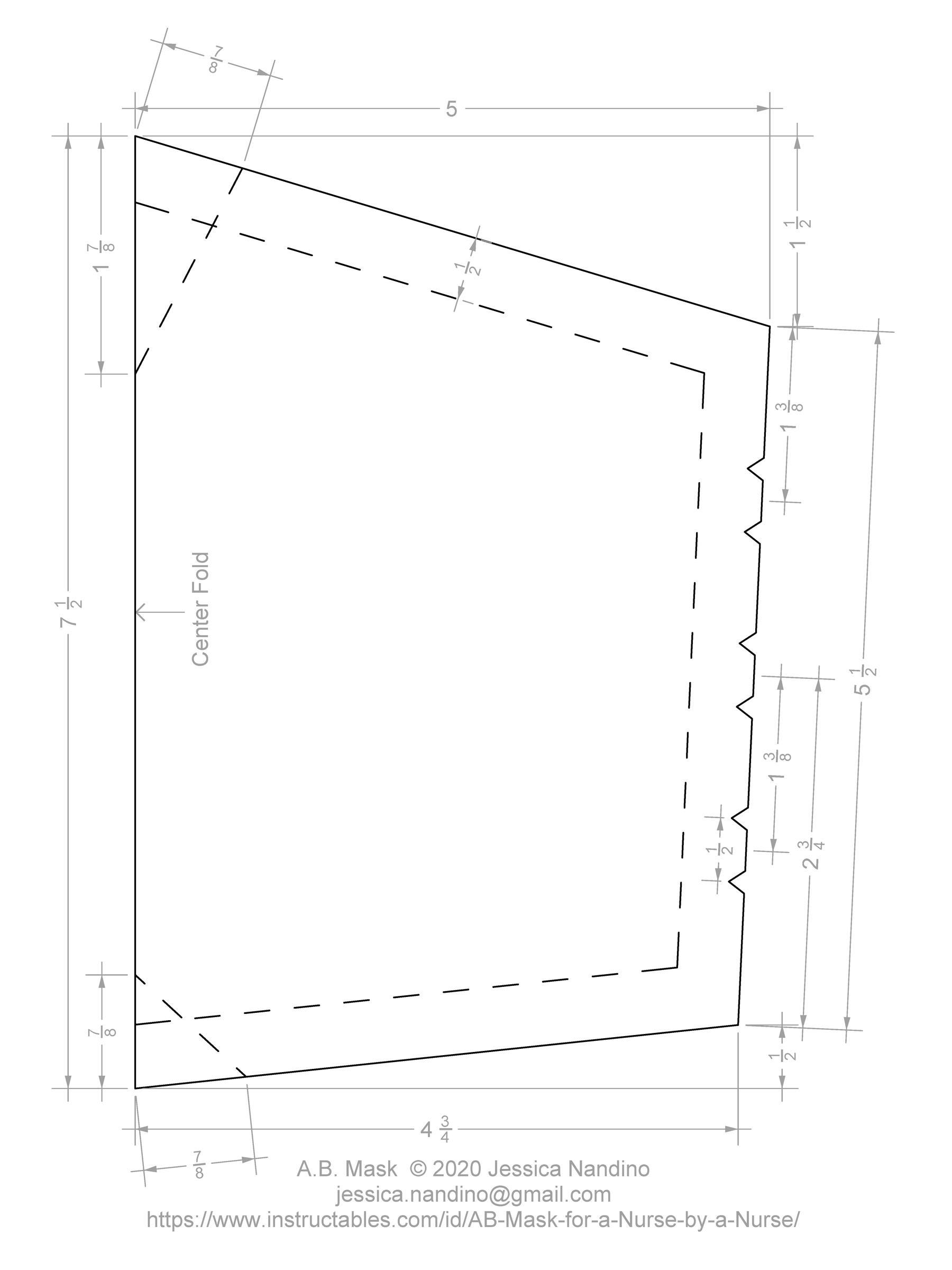

Step 1: Print the Pattern
Print the pattern. Cut out pattern. Cut along straight black lines and dotted black line.
Choose your fabric - at least 21"x18" (Fat Quarter). Iron out wrinkles.
*I have updated the pattern print out to clarify dimensions of the cutout pattern. I have also included a screen shot of the print settings I used so pattern was true to size. Thank you!

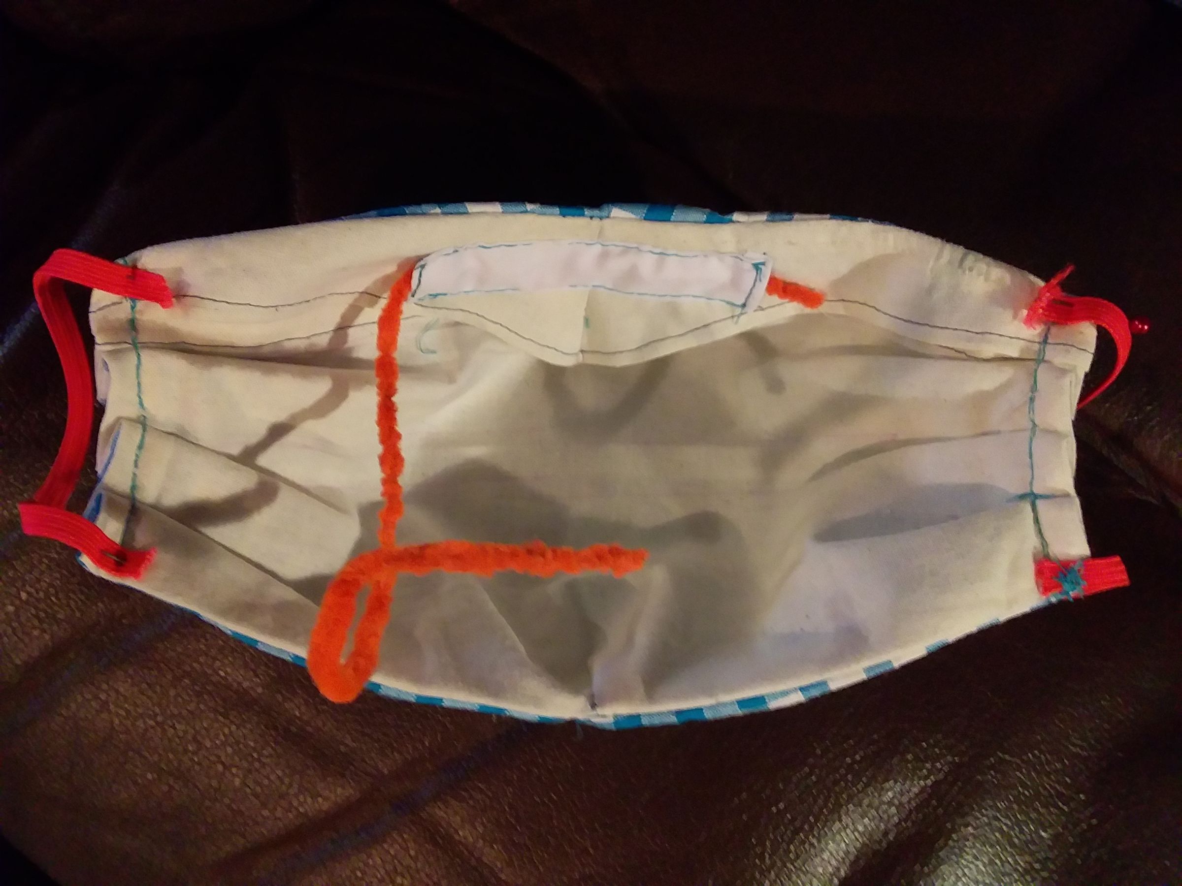

woodmsc
woodmsc
Question 1 year ago on Step 15
Some have said the masks need a wire (?) or something inserted for a secure hold on the nose. Do you have any directions for such?
0
chittah
chittah
Answer 10 months ago
I used the double wire thing from coffee packages and cut the ends so they are rounded. They don't get bunched up like thin twist ties or pipe cleaners.
0

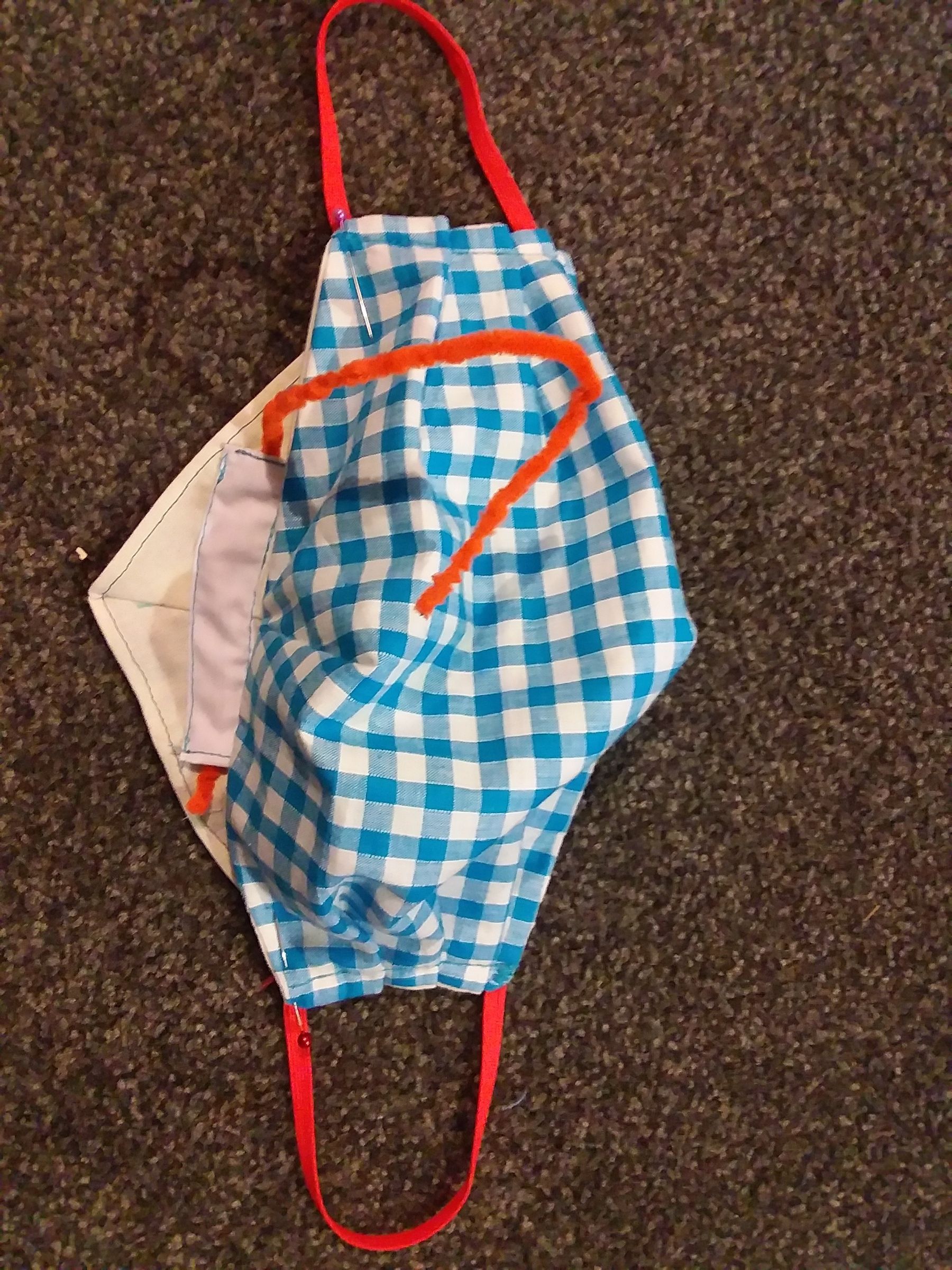

HaydeeM3
HaydeeM3
Answer 1 year ago

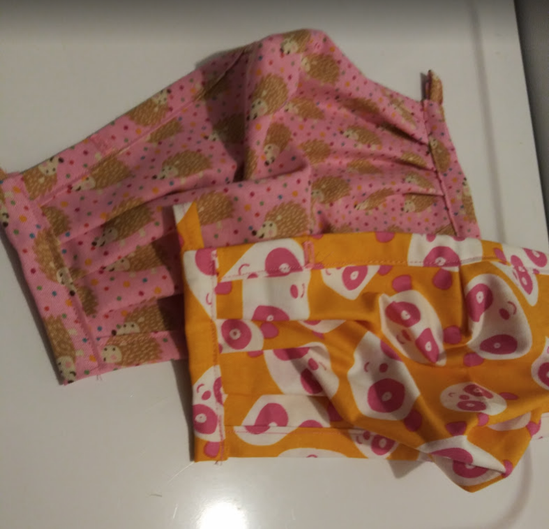

See my photos (I made a pocket for the pipe cleaner to go into for easy removal to wash) Like wise you can sew a twist tie about 8 cm (3 1/4") in length into the bias binding. probably needs to be aluminium so it doesn't rust when being washed. hope this helps.

usahotair
usahotair
Tip 1 year ago
Hi Jessica! Great work, and thanks for what you do.
I took the liberty of re-drawing your pattern so that anyone can just print the PDF at 100% scale on a 8.5x11" Letter sized sheet. Do not rescale it.
For those without a printer, all dimensions are shown on the pattern and you just need a ruler to draw it out very quickly and easily. Good luck!
Jon in Phoenix, AZ
