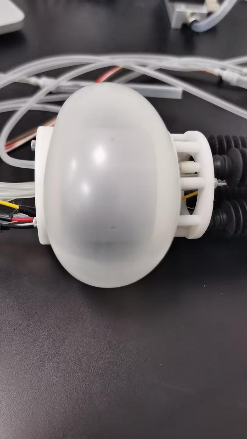

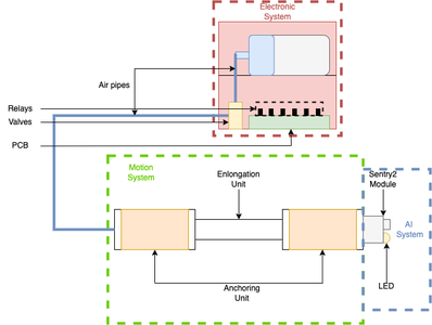

Overall Design:
The robot consists of
  1. The main body of the robot: mimics the motion of the inchworm in which it uses a 4-bellow pipe section to elongate and contract, and it has one balloon at the head and the tail each to anchor on the wall of the colorectum.
  2. The electronics system: controlled by a central PCB, it powers the motions of the robot by controlling the pneumatics system. The pneumatics system consists of 6 relays, one 6-bundle valve, and two gas pumps for pumping and sucking the gas.
  3. The AI system: uses a Sentry2 module to detect the polyps inside the colorectum using a trained Yolov2 network.

Step 1: Designing Main Body
Below are the 3D-printed parts for the robot body I created using Autodesk Fusion.
  1. Head and Tail: They are the two ends of the robot that are moved by the elongation and contraction of the bellow pipes. Gas was pumped through the airholes embedded inside their hollow chamber to pump the balloons (silicon sleeves) for anchorage inside the colons.
  2. Bellow Plate (Head and Tail): They are fixed to the head and tail respectively and are where the 4 bellow pipes connect the two ends of the robot.
  3. Hull Lids: They are responsible for clamping the silicon sleeves onto the head and tail to ensure air tightness.
Noticed that the head and tail have a slightly different design.
Why Those Differences?
This is so that the silicon tubes can properly connect to the airholes at the head, tail, and tail bellow plate without interfering with other parts.
One of the biggest challenges I faced when designing those parts is that for the screw holes on the respective parts, if I designed them to be strictly M2 standard, then the screws might not be able to fit in easily due to the inaccuracy of using regular 3D printing. As a result, I increased the diameter of each screw hole by 0.3 mm.
Important Note:
This design is intended for regular 3D printing machine to print and assemble, if you are trying to use photocuring 3D printing to replicate this project, please, if you can, adjust the screw holes to M2 standards (2mm).

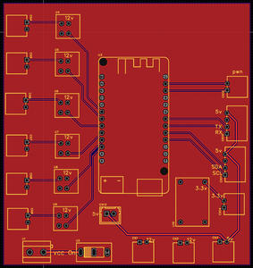

Step 4: Design the PCB
Now to power the robot, we need to build a pneumatics system controlled by electronics. The first image shows all the electronic components in my robot.
The PCB board will be connected to each of the respective components as labeled in the second image.
Noticed in the schematics above, the biggest unlabelled box is the ESP32 board, the 6 unlabelled boxes in the relay sections are the 7HA relays and the unlabelled box at the LED section is the DC-DC 12v to 3.3V buck converter (They are all not shown in the 3D image above).
For the VCC and the GND, they are all fully connected to the respective parts of the board, all you need to do is to solder the other components to the respective parts.
PS: The 4-pot connector counted 3 from top to down on the right side of the board was meant to connect to a distance sensor, but I removed that from this version of robot as I thought that might not be needed as the track of the colorectum is fixed.
Below is the 3D model of the PCB:

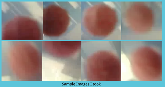

Step 6: Prepare to Train the AI Module
This is just a proof-of-concept, which I haven't done (and am currently unable to do) any clinical experiments on humans. But it can still detect anomalies in the tube-like testing environment I set.
If you want to customize your AI module, you can collect images to train your image by copying the Python file below into the SD in the Sentry2 module and renaming it to main.py.
Then, power your Sentry2, once it is finished initializing, take your module in front of your target of interest and press the button labeled in red, it will take the photos automatically for you. It is recommended to take at least 300 images to achieve the best training results.
After you have taken all the images needed, label them using LabelImg after you retrieve the images from Sentry2. You can name your targets to any name you want if you like.
For the label format, select PascalVOC.
Now enjoy drawing bounding boxes around your targets :)!

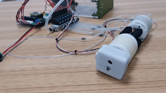

Step 12: Connect to the Power Supply (and Ready to Go)
After you finish assembling your box, connect the power slot to your 12V power source.
The system takes a while to initialize (particularly Sentry2), but after that time, it will work properly.
Watch a demo of how it moves!
The images I attached above are the photos taken by the robot during the experiment shown in the demo video.
