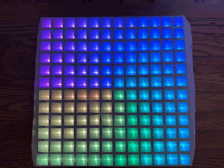

Step 3: Prep the LEDs
Now, let's start building the heart of your display by laying out the LED strips on the cardboard base.
- Prepare the Cardboard: Cut your cardboard to a size of 16x20 inches. This gives you extra space around the edges for easier handling and adjustments. You can trim it to 16x16 if you'd like, in that case you'll just need to fold your wires behind the cardboard and tape them down.
- Cutting LED Strips: Divide your 5m LED strip into twelve 12-pixel segments. This will form the rows of your display.
- Arranging the Strips: Use two strips as spacing guides at each end of the cardboard. Starting from the lower left corner, adhere the LED strips onto the cardboard,
Very important: Alternate the direction of each strip to create a seamless flow of LEDs. You will notice arrows on the strips the indicate the direction of the flow of current. This alternating pattern is crucial for programming the display later.

- Once uploaded, the ESP8266 will automatically run the sketch, and you should see a pattern of red LEDs moving up and down your strip, indicating that the installation and setup are correct.

- Assembling the Frame: Arrange the 3D printed tiles (or your cardboard alternative) around the LED strips, using hot glue or another strong adhesive to secure them in place. When my son did this, he used Elmer's school glue, which worked perfectly fine. Remember the diffuser will holder it in place to the cardboard as well. This frame not only adds stability to the display but also enhances its appearance.
- Adding the Diffuser: Lay the light-diffusing cloth over the LED strips and frame. Carefully staple the cloth to the backside of the cardboard, pulling it taut to ensure an even distribution of light across the panel. The diffuser helps soften the LEDs' brightness, creating a more visually appealing display.

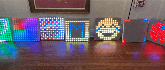

Step 8: Start Designing - With AI or by Hand
Now that your display panel is assembled, it's time to bring it to life with custom designs and animations.
- Exploring AI Tools: Utilize AI tools like ChatGPT or Bard to generate creative designs or text animations for your display. These tools can offer coding snippets or design ideas that can be adapted for the LED panel. There are additional test files that we had AI create that are in the projects file.

Congratulations on completing your 12x12 pixel display panel! This project not only serves as a unique piece of technology for your space but also as a hands-on learning experience in electronics, programming, and creative design.
- Reflecting on the Journey: Take a moment to appreciate the skills you've developed through this project. From understanding the basics of LED programming to getting a taste of soldering and exploring the potential of AI in design, you've taken significant steps in your STEM journey.
- Looking Ahead: The possibilities for expanding and customizing your display panel are endless. Consider integrating sensors, buttons, or even connecting your panel to the internet for dynamic content updates.
- What's Next?: My son and I already started embarking on our next project, a 6x6 matrix display (pictured above), which has made a great night light for him It can display the same types of designs, letters and patters just on a more portable screen & still enables him to be creative through technology at a fraction of the cost. Want to know when that Insructable will be available, just drop a comment below or sign up for updates on our blog. https://justreed.com/led-stem/exciting-developments/
