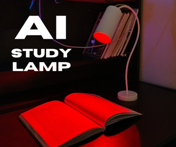

This fun project idea came to me during a conversation with a colleague at work. He was complaining about how his kids use their smartphones while studying, and end up doomscrolling after one notification pops up. I jokingly said, “What if the study lamp could get angry when that happens and alert you somehow?”

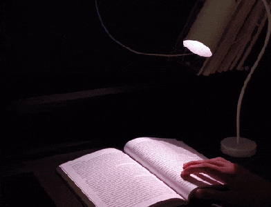

Later that day, after getting home from work, I kept thinking about the idea and decided to build a prototype. The result is this lamp with an AI camera trained to detect smartphones. As soon as it spots a phone on the desk, the lamp shifts from a soft warm white to a harsh deep red, straining the eyes and making it harder to look at the screen (kinda). Once the phone is put away, the lamp returns to its usual warm white glow.

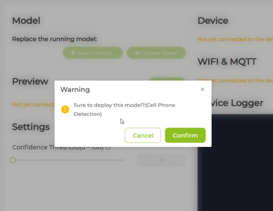

I went to the Sensecraft AI models page and searched for "cell phone detection."
This website contains pre-trained models that can be uploaded to the Grove AI module. If you don’t find the model you’re looking for, you can even train your own by uploading images of specific categories. However, for this use case, I found a suitable model already available on the site.
If you’re following along, make sure to use only the models designed for the Grove Vision AI Module v2!
Next, connect the AI module to your PC using a USB-C cable, and click "Connect Device."
Your browser may prompt you to choose a device—select the correct port (there should only be one) and confirm.
Refer to the images above for the full step-by-step process I followed.

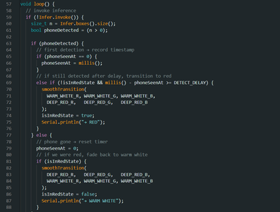

This code checks if a cell phone is detected and remains visible for at least 10 seconds, it triggers a smooth colour transition on a WS2812 LED strip from warm white to deep red, indicating the detection of a cell phone. If the cell phone is no longer detected, the LEDs transition back to warm white. The system continuously monitors the camera feed and updates the LED colour accordingly. I have done a detailed code walkthrough in the end of this instructable.

Step 9: Code Walkthrough
Configuration and Constants
- LED_PIN: The GPIO pin used to communicate with the LED strip.
- LED_COUNT: Total number of LEDs in the strip.
- Color definitions: RGB values for "warm white" and "deep red".
- DETECT_DELAY: How long (in milliseconds = 10 seconds) the phone must be continuously detected before changing the light to red.
Initialization
- strip: Initializes the LED strip object.
- Infer: Handles communication with the AI module.
- phoneSeenAt: Stores the timestamp when a phone was first detected.
- isInRedState: Tracks whether the current light color is red.
setup()
- Initializes the AI module and LED strip.
- If the AI module fails to start, the program halts.
- LEDs are set to warm white initially.
loop() – Core Logic
Inference and Phone Detection
- Infer.invoke() performs a frame-by-frame analysis.
- Infer.boxes().size() returns the number of detected objects.
- A phone is considered detected if at least one bounding box exists.
Transition to Red After Delay
- If a phone is seen, the timestamp is recorded.
- If the phone remains detected for 10+ seconds (millis() - phoneSeenAt >= DETECT_DELAY), the LEDs fade to red.
- The flag isInRedState prevents redundant transitions.
Revert to Warm White
- If the phone disappears, phoneSeenAt is reset.
- If the LEDs are red, they smoothly fade back to warm white.

So that's all! My little “angry lamp” prototype that’s not afraid to call out your phone habits!
It might be a bit over the top, but hey, if a harsh red light can make you think twice before doomscrolling, it’s already doing its job. It was a fun project to try out, even if it’ll never be a real product. I enjoyed building it, and that’s what matters most.
