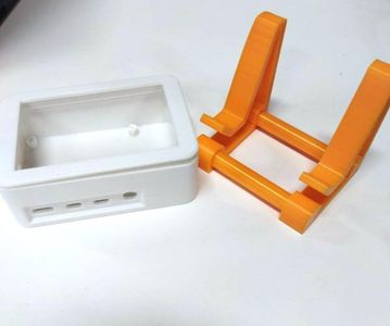

Step 12: 3d Model Case
As part of our AI assistant project, we utilized 3D printing to create a custom case (boitier) for the Raspberry Pi and the 3.5-inch display. The 3D printed case securely houses both components, offering protection against dust and physical damage while allowing easy access to necessary ports. Additionally, we designed and printed a stand to hold the Raspberry Pi and display at the optimal angle for visibility and convenience. This custom 3D printed housing and stand not only enhances the aesthetics of the project but also provides a functional and protective solution for the components.
