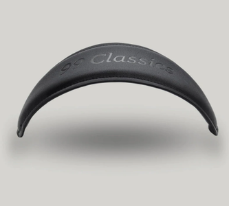

Knowing this, I was inspired by a video from DankPods showing how easy it is to replace the Meze 99 Classics headband. The Meze headband uses screw holes, a thick suspension band, and has cushioning foam inside the headband. I figured that the Meze headband might be a suitable replacement for the AKG headband on my headphones.
I set out to design a bracket assembly to attach a Meze headband to the AKG K700 series headphones while having a similar design aesthetic to that of the AKG headphones and being easy to assemble and repair. What I came up with is a two part 3D printable bracket assembly that screws together from the back and presents the original AKG logos nicely. If you are interested in trying this mod yourself, continue reading and I hope you enjoy the project!

A Meze 99 Classics headband (https://mezeaudio.com/collections/accessories/products/pu-leather-headband)

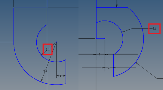

Print these models with the long, thin, flat side facing the build plate for both the SLA or FDM print. Dimensions might vary slightly for your headphones. If you need to make the holes that grab the headband bars slightly smaller, you might need to change the radius dimensions of both parts marked in the photo to 2mm. The sketches of these parts are in the first extrusion of the models.
If your resin prints turn out bent, you can dunk the spot on the parts you want to shape correctly in boiling water for about 5 seconds and bend them to shape easily. After you have parts that you are satisfied with, glue the AKG logo pieces onto the circle of the front pieces of the new headband brackets.
