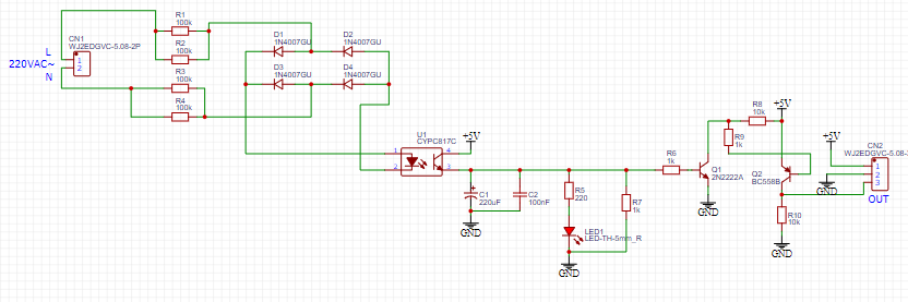

Step 1: SCHEMATIC DIAGRAM
Here we can see the schematic diagram of the project.
Step 2: FUNCTIONING
This circuit is very easy to make and interpret: we have 4 100k resistors at the input that will reduce the input voltage for the optocoupler's LED, in turn we see the diode bridge that converted the alternating current to the pulsating current and when connecting at the alternating voltage input, the optocoupler LED will be activated and also the optocoupler transistor and will activate the TTL output control stage, that is, the LED of the control stage will be activated and let the 5V pass and thus I will have an output pure 5V to activate some microcontroller or take it to binary logic.
In this way we can control any electronic device and we can use it in an automatic transfer system where we can visualize or take a census of the current of the network and the backup current and be able to supply the different loads within a house and we will obtain the quick response if the power grid goes.

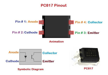

Step 3: PC817
The PC817 is a general purpose optocoupler consisting of a diode that emits infrared light towards a phototransistor, driving the transistor optically, it has a single channel DIP-4 package.
What is the PC817 Optocoupler used for?
It is used to make an isolation between two stages of a circuit, it can be applied in peripherals for embedded systems, AC motor control, control systems and more. The most common applications for the PC817 Optocoupler are:
1.   I/O Isolation for MCUs (Microcontroller Units)
2.   Noise suppression in switching circuits
3.   Transmission of signals between circuits of different potentials and impedances.

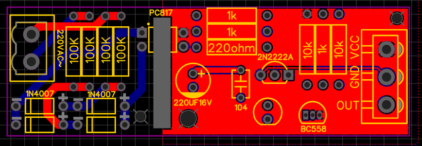

Step 6: EasyEda
Here we will see the PCB design both the tracks and the 3D image
