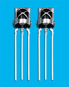

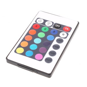

Step 3: RECIVING THE IR CODE FROM REMOTE BUTTON
This is the test to recieve the hexadecimal code of the remote button
1.install the ir remote library form the following link in the arduino / library folder
https://github.com/z3t0/Arduino-IRremote
if you already have the library installed follow the next step
2.open the arduino ide and open example/IRrecvDemo sketch into the arduino ide
3.upload the code to the arduino.
4.now connect the ir reciver to the arduino as shown in the video.
5.open the serial monitor in the arduino ide.
6.press any button on the remote and note the hexadecimal value of the button pressed
7.now you have the code of the button you can follow the next step

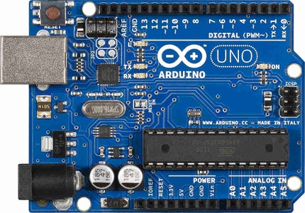

Step 4: MODIFYING THE ARDUINO CODE
YOU COULD USE THE FOLLOWING SKETCH TO MAKE 1 APPLICATION CONTROL
#include<IRremote.h>
int RECV_PIN = 11;
int state;
int led=13;
IRrecv irrecv(RECV_PIN);
decode_results results;
void setup()
Serial.begin(9600);
pinMode(led,OUTPUT);
state=0;
irrecv.enableIRIn(); // Start the receiver
void loop()
if (irrecv.decode(&results))
if(results.value==(0xpaste your hexadecimal code for example "0xF730F4" )
if(state==0);
digitalWrite(led,HIGH);
state=1;
else
digitalWrite(led,LOW);
state=0;
Serial.println(results.value, HEX);
irrecv.resume(); // Receive the next value
delay(100);
AFTER UPLOADING THE FOLLOWING SKETCH TO THE ARDUINO CONNECT THE LED TO THE PIN 13 OF ARDUINO AND IR RECIVER OUTPUT TO 11 PIN OF ARDUINO TEST IT USING THE SAME REMOTE BUTTON WHOSE HEXADECIMAL CODE YOU HAVE COPIED.

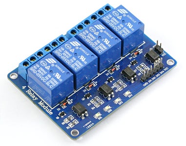

Step 5: ADDING RELAY MODULE
YOU COULD BUY A 5V RELAY MODULE FROM ONLINE AND CONNECT IN THE FOLLOWING WAY
ARDUINO RELAY MODULE
+5V------------------------->+5V
GND------------------------>GND
13--------------------------->IN1
12--------------------------->IN2
11--------------------------->IN3
10--------------------------->IN4
AND THE SAME PROCESS REPEATS FOR THE NUMBER OF CONTROLS YOU HAVE
CONNECT THE NEUTRAL WIRE OF THE MAINS POWER SUPPLY(AC) TO THE NORMALLY OPEN SIDE OF THE RELAY AND THE LINE WIRE TO HOME APPLIANCE(BULB) THE THE SECOND WIRE FROM THE BULB WILL GO TO THE CENTER PIN OF THE RELAY
[ WARNING:: PLEASE DO NOT TRY TO PLAY WITH THE 240V AC POWER SUPPLY THAT CAN KILL YOU IMMEDIATELY ]
BEFORE CONNECTING THE RELAY MODULE DIRECTLY TO AC SOURCE CHECK THE CONNECTIONS TWICE AND MAKE SURE EVERYTHING IS CORRECT
