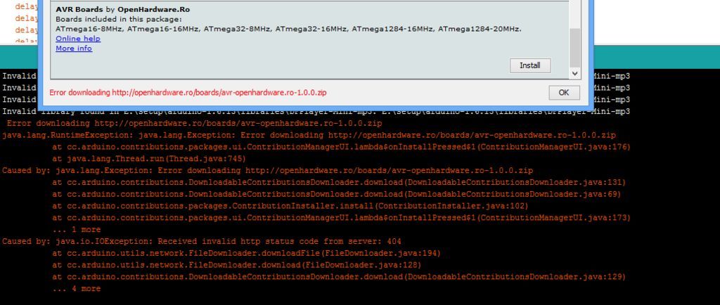

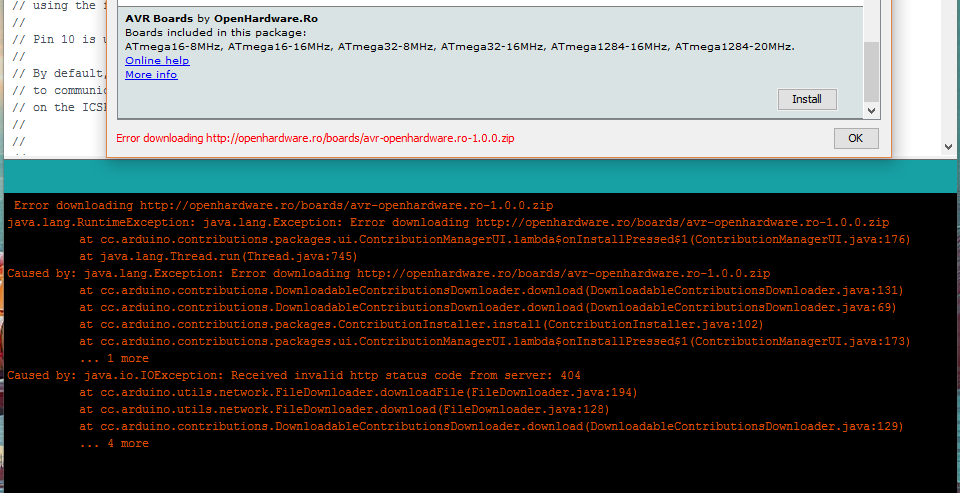

5 years ago
i am getting this error again and again. when i wanted to download AVR board in ardiuno IDE.
Reply 5 years ago
Try now... for some (unknown) reason zip file no longer exist on site.
Now I reloaded again.

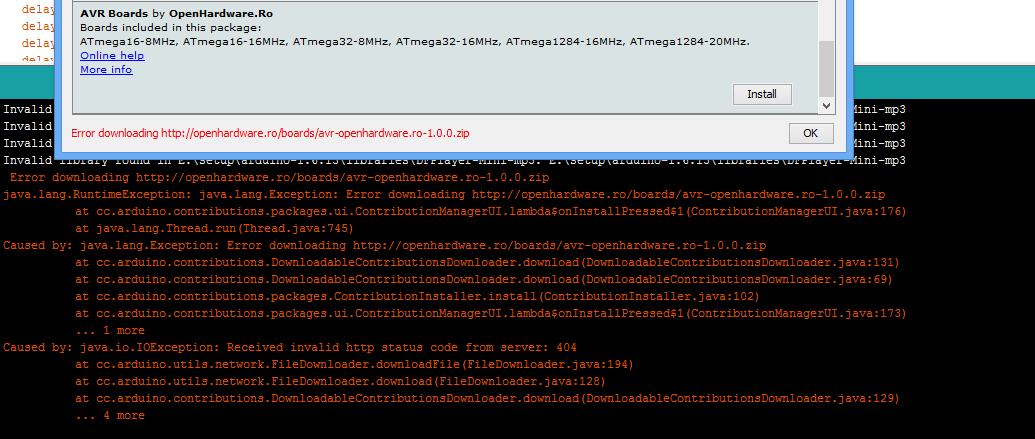

6 years ago
i get this error when i am trying to install the package.

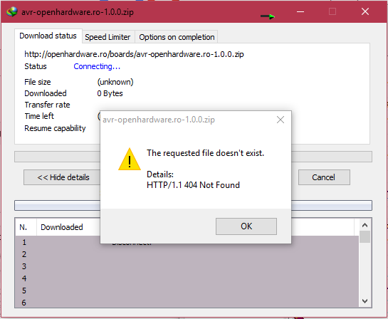

Reply 6 years ago
trying to download the link
Reply 6 years ago
You are right. I do not know why the file has disappeared.
I'll see what it's about in a matter of hours.
Reply 5 years ago
i am getting this error again and again. when i wanted to download AVR board in ardiono ide
Reply 6 years ago
Problem solved. Still I do not know why the file has disappeared.
You can try again now.
Reply 6 years ago
thank you it works
