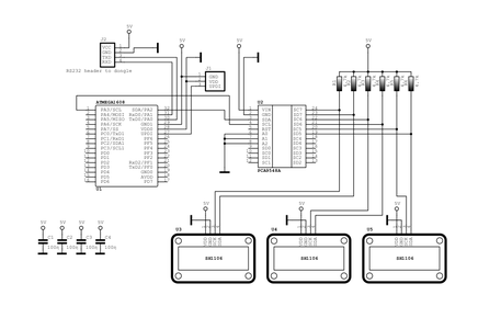

Step 2: Connect Mega1608 to PCA9548A
Connect CPU PORTA SCL pin 1 to PCA9548A PIN4 SCL pin 4
Connect CPU PORTA SDA pin 32 to PCA9548A PIN4 SDA pin 3
Step 3: Connect PCA9548A to SH1106 OLEDS
Connect PCA9548A addressing pins A0,A1,A2 to ground zero to make the I2C address 0x70 and use it in MCU programming code
Connect PCA9548A channels to each and every OLED using pull up resistor for each I2C connection.
Step 4: Connect Mega1608 UART to TTL Serial Converter
Connect CPU UART-0 PORTA RxD pin 31 to RS232 TTL Converter
Connect CPU UART-0 PORTA TxD pin 30 to RS232 TTL Converter
