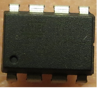

AT tiny 85/45 - available from Mouser  556-ATTINY85-20PU  Need more info on the AT tiny check out the data sheet here.

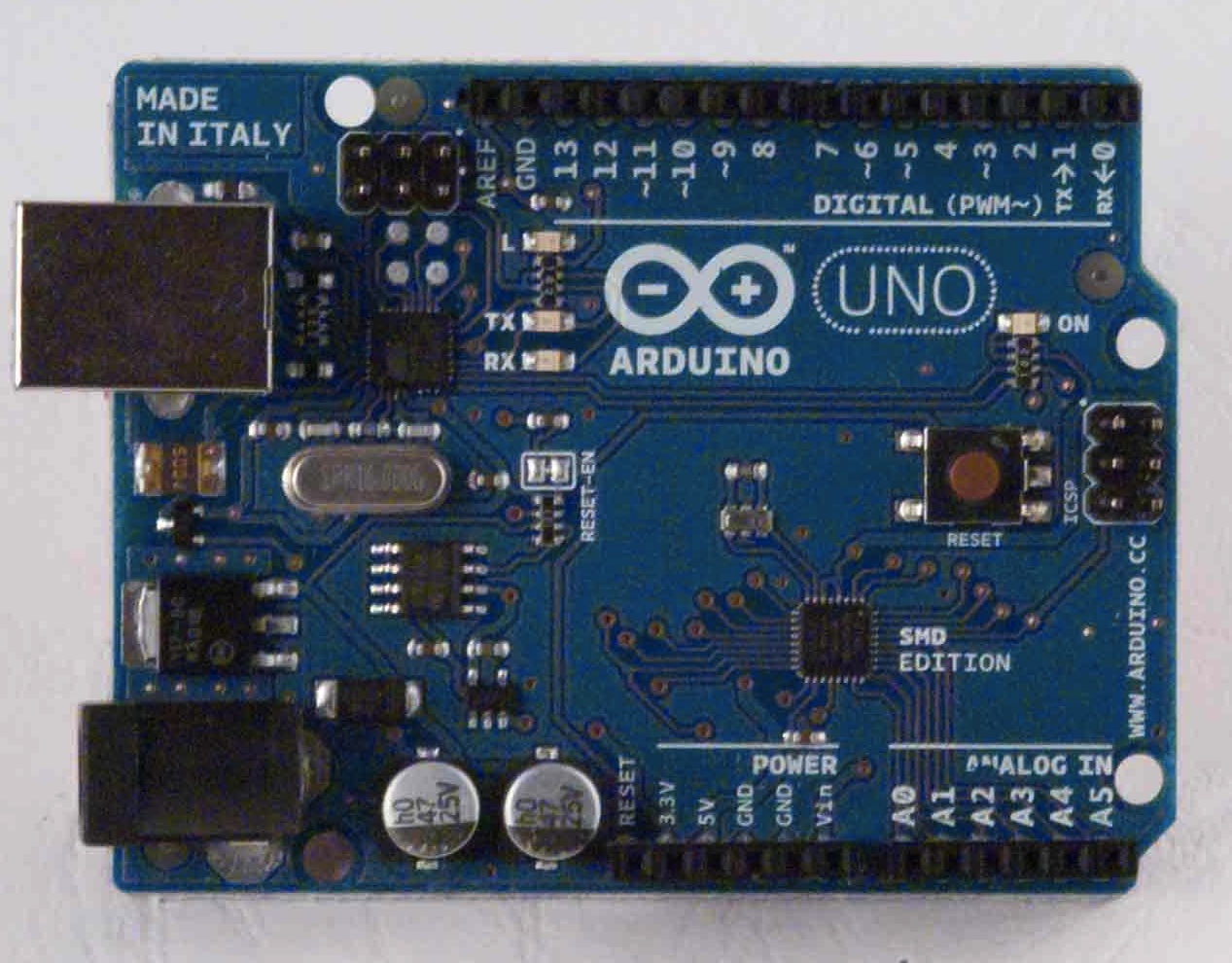

You will be using the following arduino pins (see pic)
5V +
5V Ground x2
10
11
12
13
Reset

ATtiny  pin# 1 to arduino pin# 10
ATtiny  pin# 4 to arduino 5v ground
ATtiny  pin# 5 to arduino pin# 11
ATtiny  pin# 6 to arduino pin# 12
ATtiny  pin# 7 to arduino pin# 13
ATtiny  pin# 8 to Arduino 5v +

Turning the Arduino board into a programmer
We’re going to use the Arduino board to program the ATtiny45 or ATtiny85. First, we’ll need to turn the Arduino board into an “in-system programmer” (ISP). To this:
Run the Arduino development environment.
Open the ArduinoISP sketch from the examples menu.
Select the board and serial port that correspond to your Arduino board.
Upload the ArduinoISP sketch.
