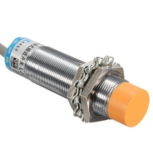

in generally we use in 3d printer NO and gnd at trigger about 5v.
There is a two type sensor ,pnp and npn.
npn sensor
when it connected to 12v ;
not trigger, give 8 -9 v which is ok for 3d printer
trigger, give zero volt , so everything is ok for 3d printer
pnp sensor
when it connected to 12v, it gives 12v at trigger. so it will damage 3d printer.
if your pnp sensor is working when cennected 5v , it is ok , but not working you should reduce the output voltage to 5v or less and you change the firmware for pnp sensor.

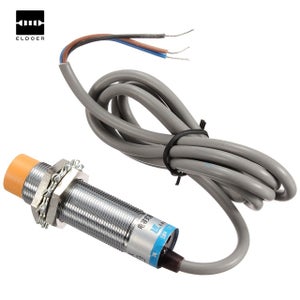

I have experience in capacitive npn sensor and ı will mention about this type of sensor.
I buyed this
https://tr.aliexpress.com/item/High-Quality-LJC18A3-H-Z-BX-Approach-Sensor-Cylindrical-Capacitive-Proximity-Switch-NPN-6-36V/32627840658.html?isOrigTitle=true

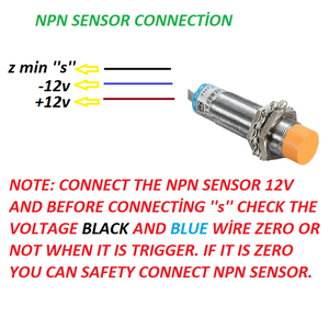

Step 2: Step2: Connecting Sensor to Ramps1.4
In general brown +
blue -
black output.
also you can check from sensor datasheet.
connect brown and blue to 12v + -
and black to the z min ends stop ,''s'' pin
