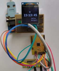

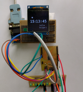

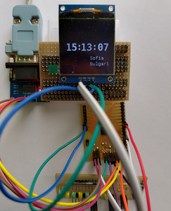

This project demonstrates building a simple desktop clock using AVR-DA's RTC and an OLED lcd screen. The clock can be set to the correct time through the use of the 2 buttons connected to MCU port. It also sends the time over one of the CPU UART channels to a desktop PC.
Step 1: Hardware
AVR128DA32 adaptor board is at the heart of the project.
It connects to and controls SH1107 OLED display through I2C interface
TTL Serial Port Converter is used to connect CPU to a PC and use it as an extra display

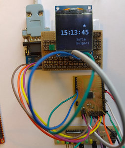

A hardware button is used to set clock to either NORMAL mode or time SET mode
When in SET mode a small star symbol appears at the top of each digit to set (hour;min;sec)
The second hardware button round robins through the digits
If hour is set, it counts from 0 through 23
If minute is set it counts from 0 through 59
If second is set it counts from 0 through 59
