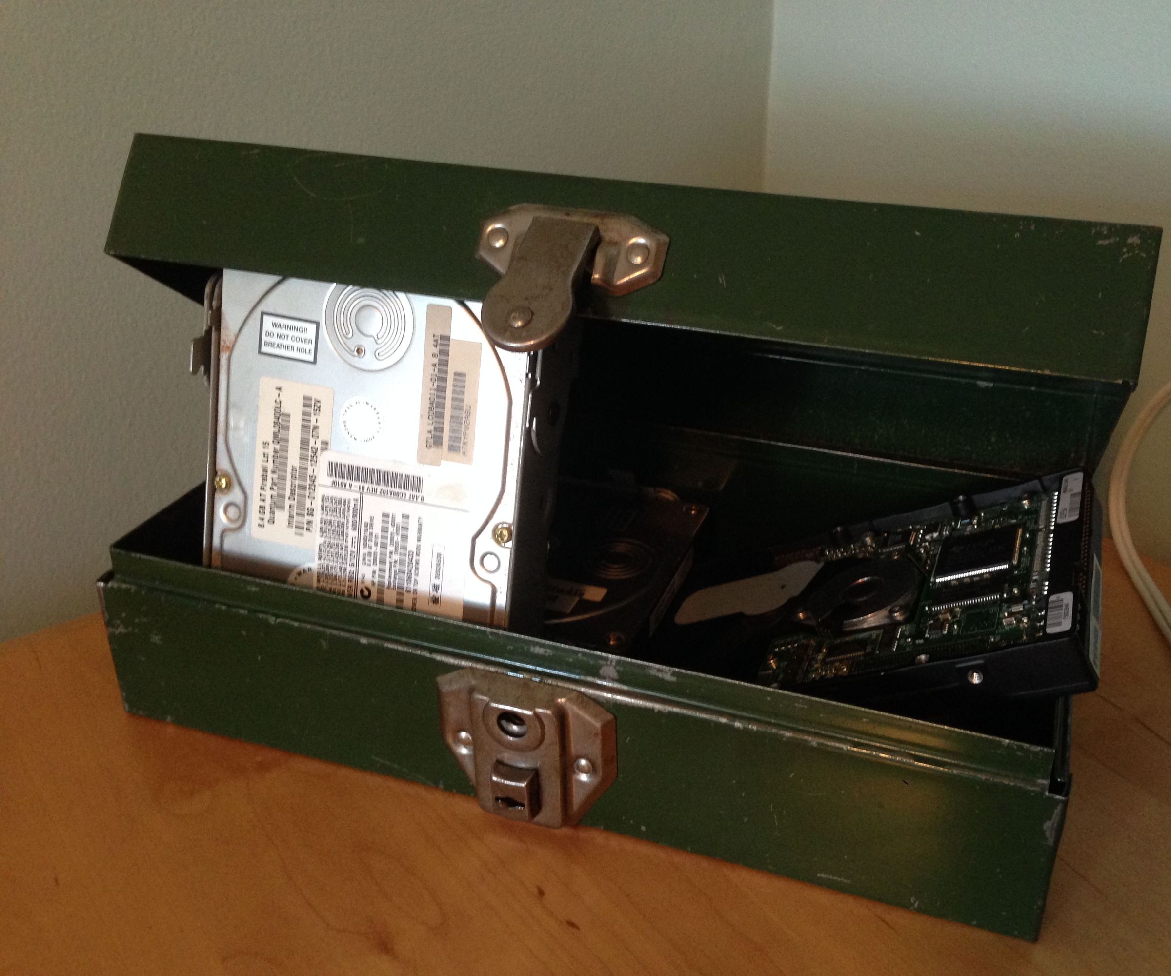

Introduction: Acetone Print Transfers
I was recently in a discussion with a fellow modder over at BitFix about making a logo for the carrying case of his mod, I suggested an acetone transfer might work, but at the time I had no idea what the process was, so I looked into it more. I found out that its pretty easy and can result in very nice prints.
