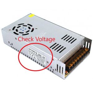

Step 1: Check the Voltage of Your Power Supply and Determine the Voltage of the Led Strip
First of all you have to check the voltage of the power supply of your 3d Printer. Of course, not all 3d printers have the same power supply, but a lot of them have an 24 volt power supply. This is a very important step in order to decide the voltage of the led strip you are gonna purchase.
You can find the voltage rating of your power supply, in a sticker that's on your 3d printer's psu. It is usually on the side of the psu. I have a humble Neptune 2, which uses an 24volt psu, so I am gonna choose a 24 volt led strip. In other case, choose the voltage of the led strip accordingly to the voltage of your psu.

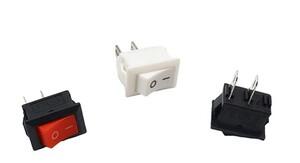

I used a KCD1-11 switch in order to turn on/off the lights, because I didn't want them to be always on when the printer is working. I wanted the led's strip control switch to be just under the printers on/off switch.
I used this 3d printed mount, which you can download: https://bit.ly/3JYsJlc
Install the switch into the mount. Then solder the end of the red wire coming from the led strip to one of the contacts at the back side of the switch. Then, use a new red cable, solder it to the other contact and make sure its long enough in order to reach the psu unit. You can use the aluminum frame in order to do some kind of cable management.

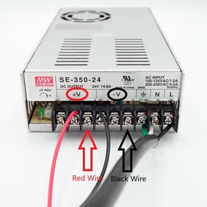

Unscrew the screws of the PSU unit and take it out of the 3d printer's frame. Locate the front side of the PSU where all the cables are plugged into the unit . It should look like the one in the pictures.
We need to connect the red wire that comes from the switch under the V+ sign, in one of the empty spaces without cables. Again , we need to connect the black wire that comes from the led strip under the V- sign, in one of the empty spaces without cables. Just unscrew the screws, insert the cables and screw them again. Make sure they are well connected.
