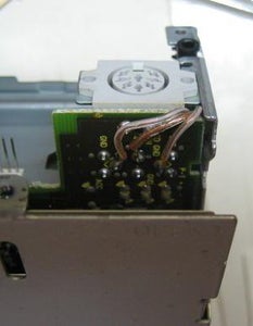

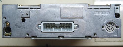

Step 2: Locate the CD Changer Plug & Pins

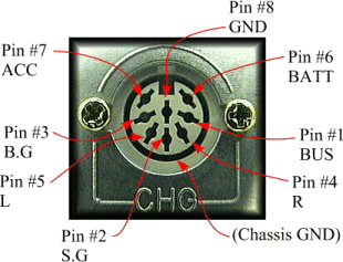

Locate the CD changer plug and gain access to the pins for audio transmission from CD changer to head unit. It should be something like the socket below in the lower right hand corner. They usually have about 8 or so pins arranged in a circle.
Now here's where you have to do a bit of googling. Figure out what the pin layout is for your radio's CD changer. Try searching with something like "Honda Accord 1996 CD changer pinout" I was able to find this layout for an Acura which was close to my Honda for the basis of mine. Remember, there's only a couple car makers, so there's a lot of similar equipment out there across brands. Honda Civic may be close to the Accord, and also close to an Acura. The same should apply for domestic cars made by the same manufacturer.

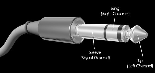

The 3 pins you need are:
Signal Ground
Left Channel
Right Channel

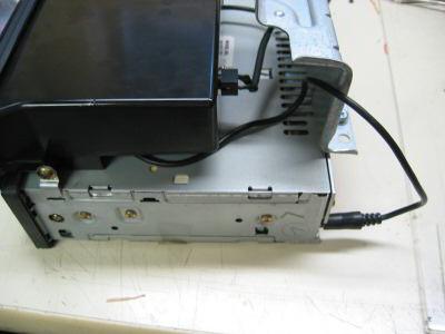

Step 3: Solder in Aux Input Jack
Once you have identified the audio pins, find a place to mount the internal jack. Using short pieces of small gauge wire, solder connections from the pins on the stereo to the pins on your panel mount 1/8" audio jack. Be sure to keep the signals correctly matched to the right pins so you don't end up crossing channels or ground.

On mine, I had a spacer/junk bin that was right below the radio. This made an excellent location to mount the external jack since it was inconspicuous and also I could wire it up at my workbench instead of in the car. Choose the location you like best to mount the jack. Push the jack through your hole you drilled and use the nut supplied with the jack to screw onto the jack and hold it in place.

You can see here's my setup with the jack installed. Sleek and WAY better than an FM transmitter.
