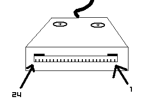

open the lg plug on the end of the charge cable, if it's a car charger, there will most likely be a small circuit board on the inside. desolder and remove the board and/or wires.... all of them. using pliers, carefully remove the pins and move them to pins 5, 10, 15, 16, and 19
Step 3: More Chopping...
cut off whatever usb device was on your cable, and solder the wires to the lg plug as follows:
note: usb vcc is connected to two pins
LG pin | USB wire
5 | Vcc (red)
10 | Data+ (white)
15 | Data - (Green)
16 | Vcc (red)
19 | Gnd (black)

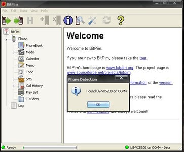

unplug the phone, then download and install bitpim from bitpim.org.
plug the phone in then run bitpim, it should automatically recognize the phone, if not, check your drivers and/or wiring.

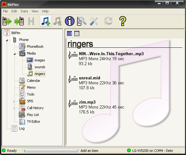

open bitpim, expand the phone tree, then the media tree, and click ringers. click the add item button (it should have turned into a music note (two eighth notes, to be precise) with a plus sign)
navigate to your ringtone and open it.

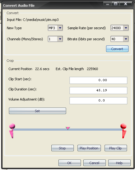

Step 8: Convert It With Bitpim.
you should now have the convert audio file dialog open. under new type, select mp3 (default), you can make the sample rate whatever you want, i use 24000 hz since it sounds good, and since you won't be able to tell if it's any higher with the crappy speaker (and i don't know the maximum my phone can handle). select one channel as you'll only be able to hear one, and it saves space. the bitrate can be whatever you want. the higher it is the more space it will take. if it's a short sound (like a 22 second clip) you can afford some reasonable quality. 40kbps sounds just great at 24000 hz mono. click convert. now play it, see how it sounds, if you don't like it, change the options and do it again. i recomend increasing the gain (volume). careful, it may cause over modulation. (if you don't know what it is, set the volume realy high and play it!!!) check the amount of space left on your phone and see if the new ringtone will fit. (menu>get it now>info>memory) if it's all in order click ok.
Step 9: UPLOAD!
this is the part verizon doesn't like! click the syncronize phone with bitpim (upload) button. (the phone with the arrow pointing at it) under source, check ringtone, and set it to add. click ok!
now wait. when the 'lights' turn green, it's safe to disconnect
